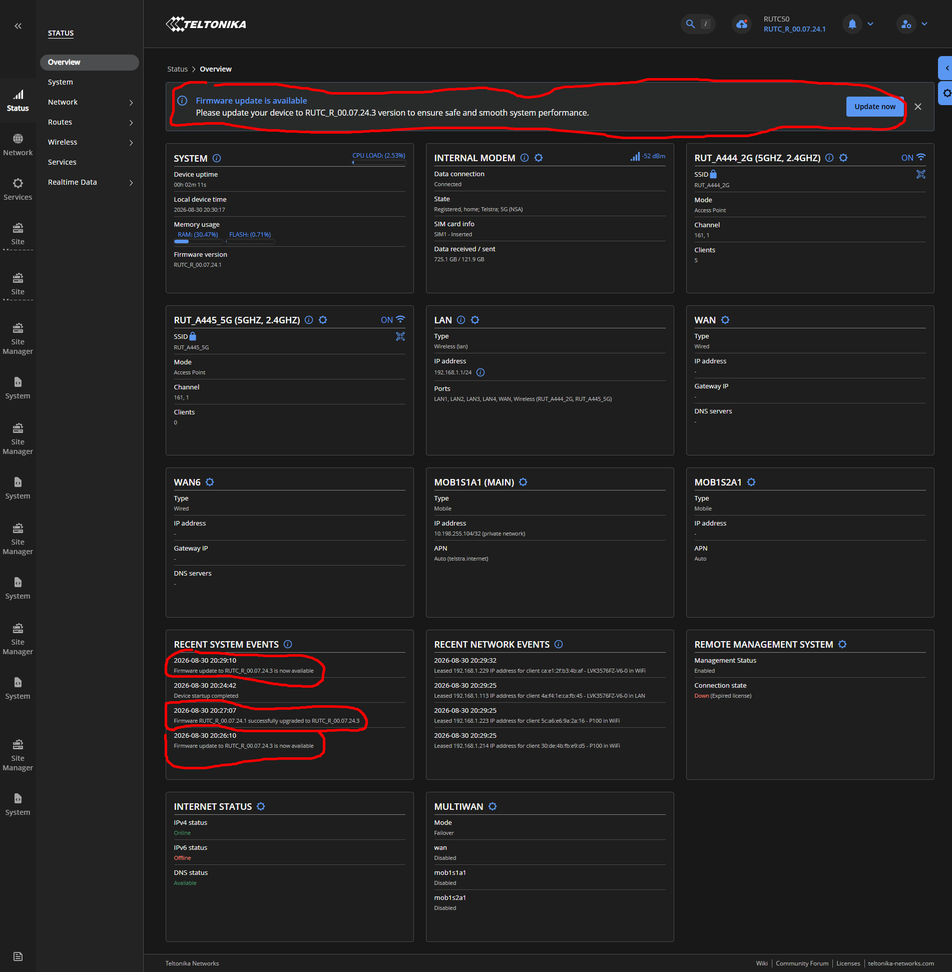

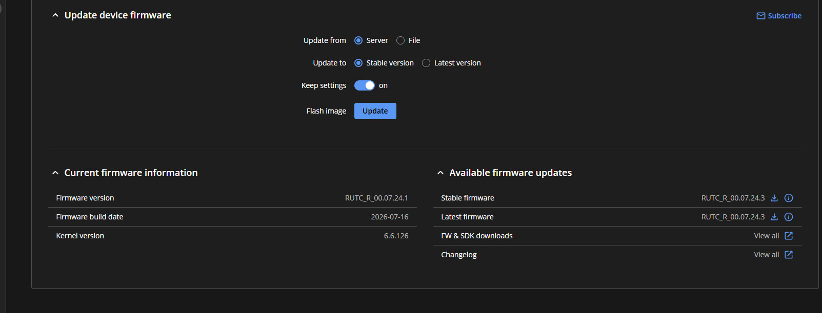

Latest update keeps asking me to update

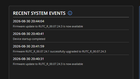

how come i get reminders of updates ive downloaded it twice already and its still asking me to update
this is my 6th time what is going on? im in a endless cycle of this update not updating

Thank you for reaching out and bringing this to our attention!
The version RUTC_R_00.07.24.3 has a known issue where firmware upgrades could revert or fall back to the previous version on RUTC family devices.
This behavior has been addressed in our latest release. Please update your device to firmware version RUTC_R_00.07.24.4 (released on 2026.08.31), which contains a fix specifically resolving the fallback issue during firmware upgrades.
You can download the latest firmware directly from our wiki page or through the WebUI of the device: RUTC50 Firmware Downloads - Teltonika Networks Wiki
Please let us know how it goes!
