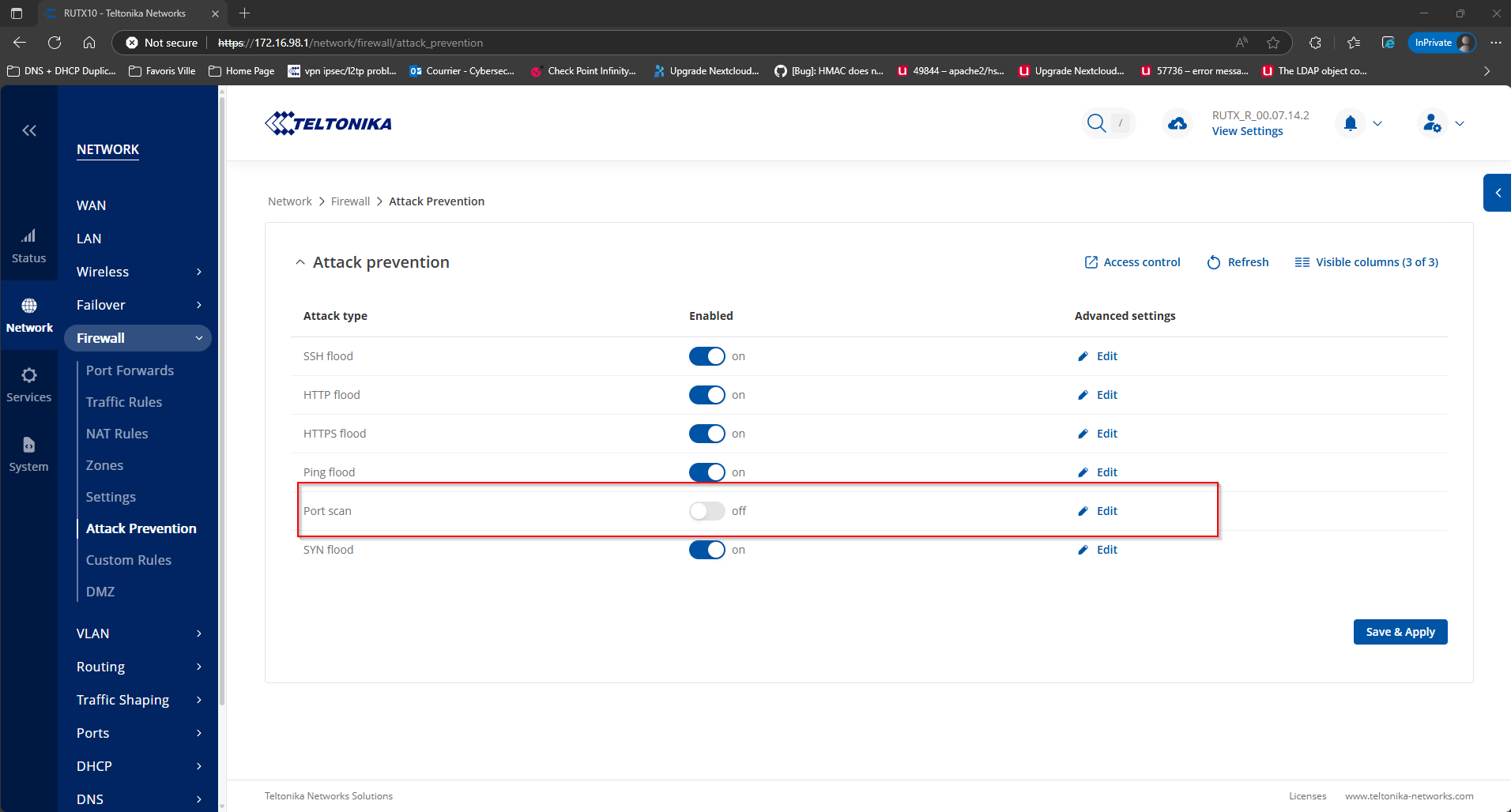

I can’t connect anymore to the firewall after upgrading to RUTX_R_00.07.14.2 from remote side in IPSEC VPN Tunnel. Anyone found the problem ? I can ping it but cannot access webpage. On local side everything is ok
I just found this: If i disable “Port Scan” in Network - Firewall - Attack Prevention im able to connect from remote side to the firewall web page on IPSEC Tunnel. Can someone test this
Seem to be this solution : Https from wan side on 7.12 now taking minutes - NETWORKING SOLUTIONS - Teltonika Community

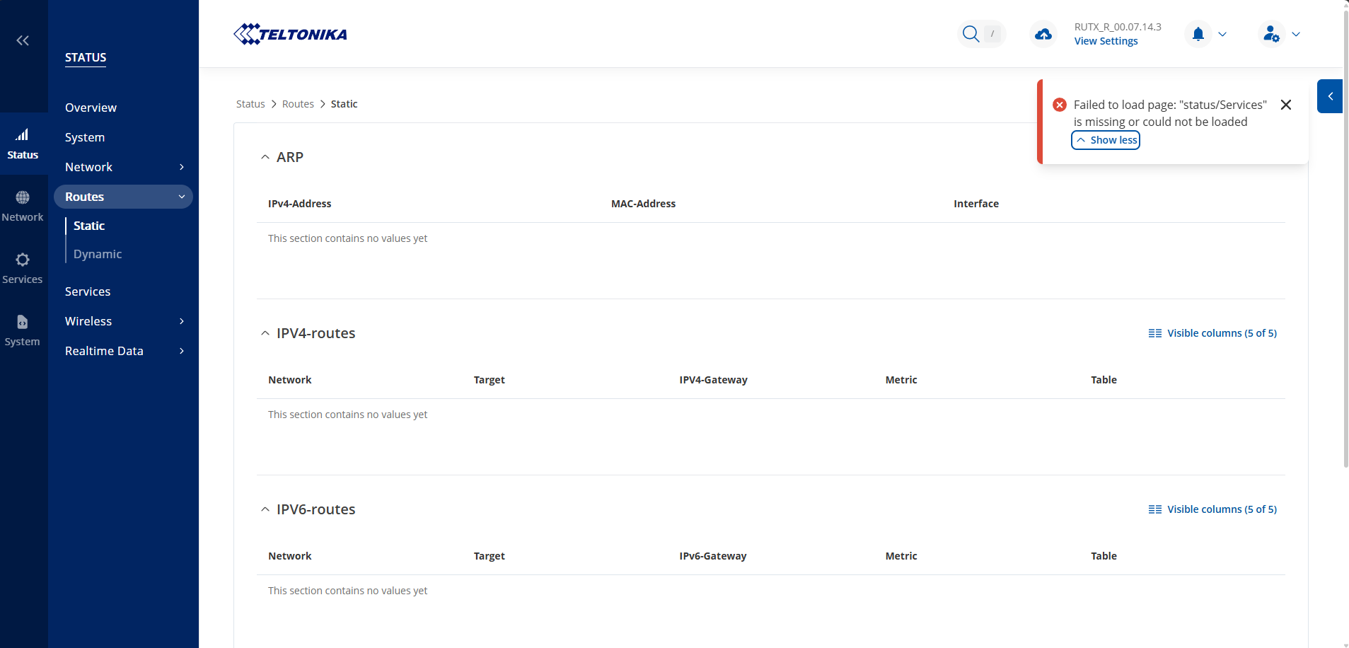

Ive update to firmware 7.14.3 and over IPSEC VPN im still having issue with the https WEBUI page. It take long time to load the page and sometime i have error like this
With older firmware like 7.10.2 everything was working fine.
Anyone can help me at Teltonika with this please

Could you please confirm whether the initial issue with the L2TP over IPsec tunnel is now working properly? Also, do you still encounter the “Failed to load page: status/Services…” error after trying to refresh the WebUI page, clearing the browser cache, or rebooting the device?
Well the initial issue was alway having trouble accessing webUI over IPSEC tunnel and the issue still persist with firmware 7.14.3. If i access webUI page over WAN and LAN everything is ok. I have 5 differents RUTX08 firewall with site to site and they do all same problem. Ive tried different browser clearing cache and still the same thing

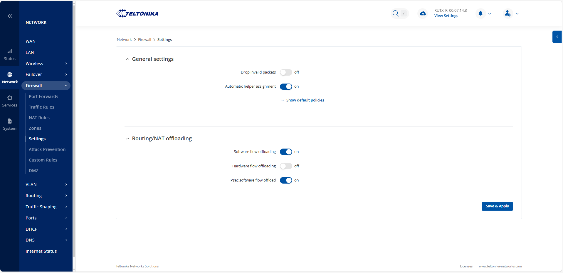

What encryption is used for IPsec? Could you try enabling the “IPsec software flow offload” option found on the Network → Firewall → Settings page, and check if that gives any improvement?
Ive tried with IPsec software flow offload and reboot the firewall and still the same issue

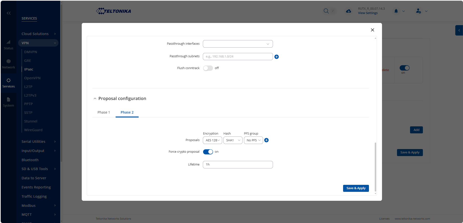

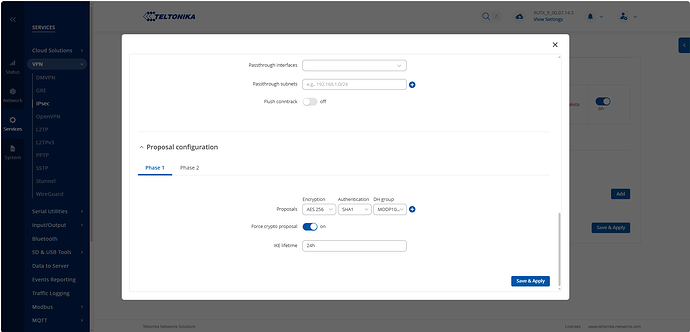

From the first glance, there’s a mismatch between the IPSec Phase 1 and Phase 2 proposals. Also, for testing purposes, leave the “Hardware flow offloading” in Firewall → Settings enabled.
Furthermore, could you check the Network → Firewall → Attack Prevention page on the device? It’s possible that HTTP or HTTPS flood prevention settings are enabled there; if so, disable them and leave only the single SYN flood enabled.
Let me know how it goes.
I tested what you ask and it did not change anything
