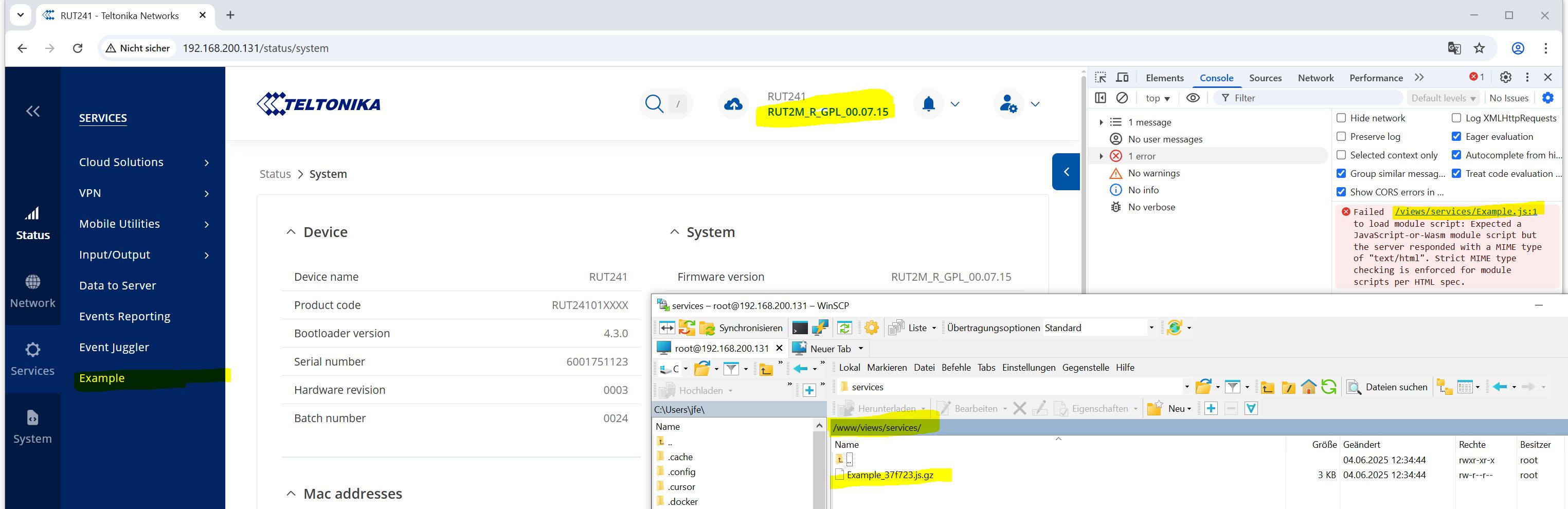

Today I tested the new version of SDK 7.15 on the RUT241, and the error still persists. (screenshot)
Looking forward to your feedback,
Jorge Fernandez
