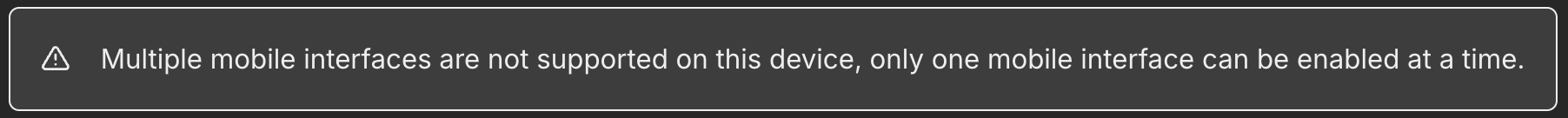

Doing this request, the following error appears in my devices list in RMS.
It seems like it doesnt find the Mobile Interface that is already enabled by default, but tries to create a new one instead?
Any help towards this issue would be great :slight_smile:
Found the issue :slight_smile:
I looked at the direct request from the network, when doing it manually, and the search_elements was wrong. it should be:
search_elements: [
                        path: '/interfaces/config',
                        search_key: 'id',
                        elements: [
                                key: 'name',
                                value: 'mob1s1a1'
