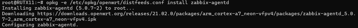

The Zabbix agent is an OpenWRT package that is not officially supported by us, and therefore it is not included in our feeds. However, you can still try installing it from the OpenWRT feeds at your own risk. Here are the commands for installing. I’ve tested them and they’ve worked:
opkg -e /etc/opkg/openwrt/distfeeds.conf update
opkg -e /etc/opkg/openwrt/distfeeds.conf list | grep zabbix
opkg -e /etc/opkg/openwrt/distfeeds.conf install zabbix-agentd
These have been tested on a RUTX11, firmware version 7.15.2:
