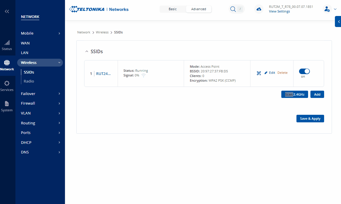

Attached below is a simple GIF that guides you through the entire process of connecting to another wireless access point (AP) and sharing its internet connection with a LAN network. In this example, my computer is directly connected to the RUT241 router.

I want to create not only a LAN but also a Wi-Fi network. Is it possible to do this?
I want to use RUT241 as a hotspot. I want to create a new Wi-Fi network by connecting it to another Wi-Fi network.
To set up a hotspot, you’ll need to use the Hotspot functionality, not the general wireless network settings. You can find this option by going to Services → Hotspot. For more detailed information, please visit the RUT241 hotspot functionality page.
If you have any other questions about setting up a hotspot, feel free to ask. You can also search this forum, as setting up a hotspot is a common topic.
