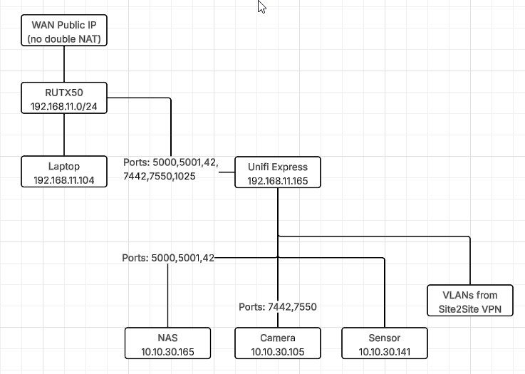

Here a short topologie of the situation.
All starting with the Unifi Express is existing and was working with the old modem. I only replaced it with the RUTX50. No firewall or anything blocks the access to the NAS or camera. NAS accessible from Laptop hooked to the RUTX50 via 192.168.11.165:5000 or 5001. Same for other ports listed that finaly should be working from WAN again.

Just to confirm, according to your setup, you want to forward traffic from the RUTX50 WAN to devices on the UniFi LAN network, correct? And you already have a port forwarding rule configured on the UniFi side to allow traffic from WAN port 5000 to LAN port 5000?
