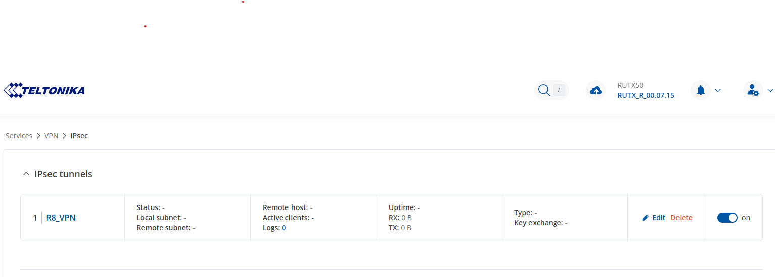

After sending a “Reset mobile connection” SMS to a RUTX50 the device correctly resets the mobile connection. The IPsec VPN does not reconnects. In the ‘log’ no lines are added. The only way to make the VPN reconnect is to reboot the device.

RUTX50 is on firmware RUTX_R_00.07.15
The issue has been happening since we set up ipsec (1 year ago). Up until now we always sent a ‘reboot’ command, but then the connected wifi devices also disconnect and reinitialize and we would like to avoid that.
I enabled the ‘flush conntrack’ option, but that didn’t help.
