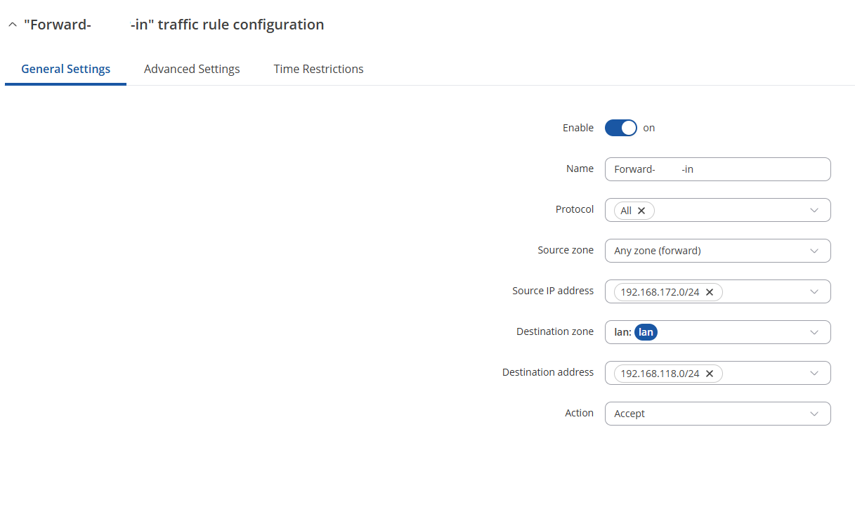

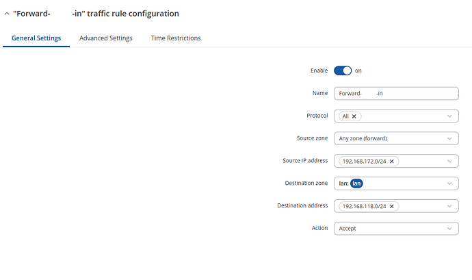

When I changed the “Source Zone” on the default “Forward” policy for the VPN connection from “WAN” to “Any Zone”, all communication started working.

The policy is the default policy that forwards traffic from the ipsec tunnel to the lan on the RUTx. The policy is auto created when I create the ipsec tunnel.

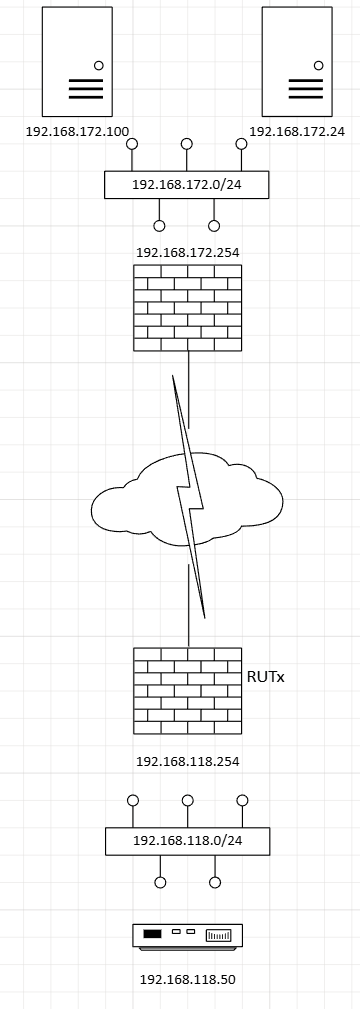

The 192.168.172.0 network is a network at my main office.
The 192.168.118.0 is the lan network behind the RUTx router.
The thing that was NOT working was http traffic from the 192.168.172.24 server to the PLC 192.168.118.50.
Ping and modbus traffic worked fine.
Http traffic from the 192.168.172.100 server worked fine.
As soon as I changed to “Any Zone” in the default policy 192.168.172.24 could talk http to 192.168.118.50
