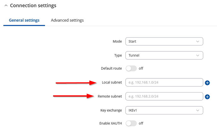

I have a RUT 240 connected via IPSec VPN to a Fortigate firewall. I have managed to get the VPN connected and I can get Traffic to flow from the RUT240 to the Fortigate and the devices on the Fortigate network. I can get traffic from the Fortigate Network to reach the RUT 240 Gateway IP, but I can’t get traffic past the RUT 240 to devices on the network.
Not having much experience with Teltonika in the past I’m not sure if there is a route or policy I need to setup on the RUT 240 to allow inbound traffic from the IPsec VPN to the internal network. Any guidance anyone may have would be greatly appreciated.
