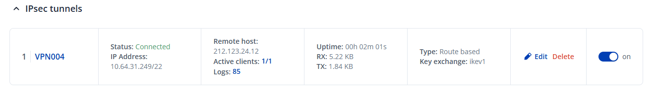

I have a working setup with RUTX10 that creates a IPSec to a Palo Alto firewall.
However when I reboot / or load a config from a back the IPSec tunnel status is connected but no traffic is passing.

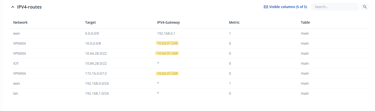

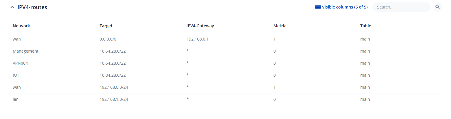

Update: It seems that after reboot my static routes for the VPN are missing.
Hitting the save and apply buttons adds them back again? Why would default routes not be registered after a reboot?

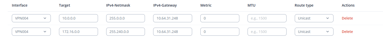

I encountered the same case as you. The solution is to leave the IPv4 Gateway blank.
The static route still shows after rebooting the device or reconnecting the VPN tunnel.

The no gateway solution worked however don’t really understand why.
