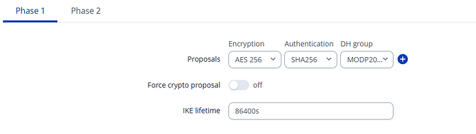

Hello, we have 2 IPSec IKEv2 tunnels configured in RUT241 (running RUT2M_R_00.07.17.1). The tunnels are working fine, but after a week, the RUT is starting to propose different encryption algorithms and PSK. As an example here we have only 1 proposal

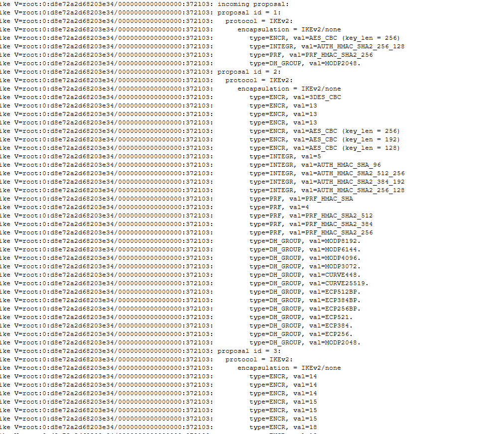

But when tring to connect RUT is coming with 3 different proposal
and, most problematic, the PSK is wrong
Lifetime is configured to 86400s, so 1 day.
