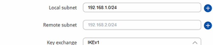

That error can be caused from different situation. Probably there is an error, when negotiating between network announcements appear.

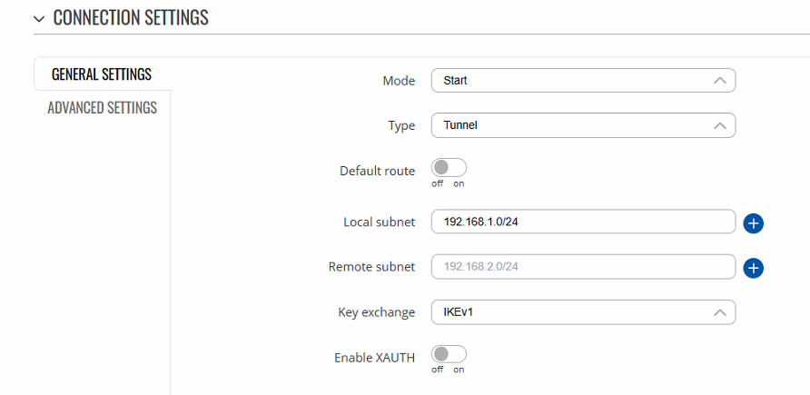

I did mention you didn`t fill up, the fields on your RUT device, where is remote subnet is not set:
And on the side of Sophos, check if there is all correct!
So generally on RUT remote subnet – means local private or real IP just to provide tunnel peer identification by addressing virtual interfaces for the booth side of the tunnel, remember IP addresses should be from the same subnet for both sides, those ip work as an identifier, like a number of doors where located some resources, mostly used when you build some dynamic routing announcement like OSPF or BGP.

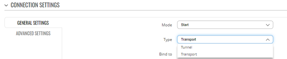

You can set your tunnel with operation mode Type: Transport, in this case, you don`t need to provide IP on the tunnel sides:

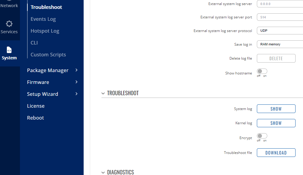

Also if you can to share with me logs from your device:
Here you can find how to download logs, System->Troubleshoot, which you can find here:

When you reply with message, here you can upload file, with using this function in top
Also remove any personal or sensitive information from log files.
