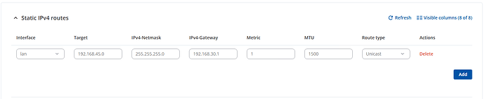

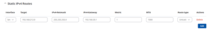

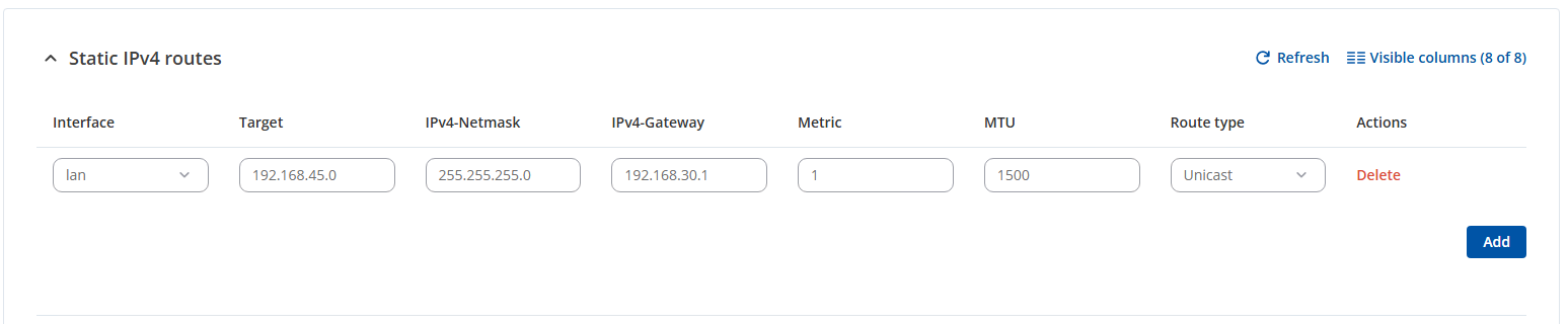

In brief, this setup should be possible to configure by adding static routes on both RUTs like the following:
  • Route A: to LAN IP (or subnet) of Teltonika B via IPsec server as gateway
  • Route B: to LAN IP (or subnet) of Teltonika A via IPsec server as gateway

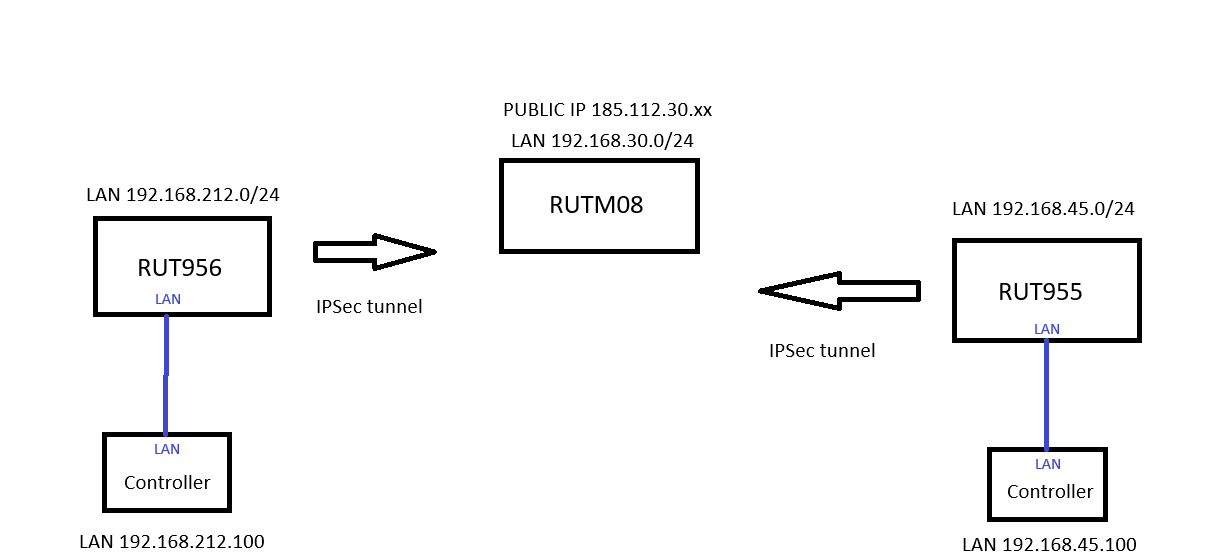

Could you please provide a simple topology diagram including the IP addresses of the hosts and an indication of how the devices should communicate? This would be very helpful and greatly appreciated for understanding your setup.
In addition, if possible, please include screenshots showing where the routes were added or any other related configurations that you’ve already tried. Thank you.
I am sending a simple topology including IP addressing.
My goal is for the Controller with IP address 192.168.212.100 to see directly on the network the Controller with IP address 192.168.45.100.
Is it understandable like this?
Thank you for help
From the RUTM08 device I have access to both 192.168.45.100 and 192.168.212.100
However, I need 192.168.212.100 to have access to 192.168.45.100
routing rule set to RUT956 (192.168.212.1)
routing rule set to RUT955 (192.168.45.1)
Good day, can’t you think of something I’m doing wrong with the routing? I really need to get it working, but I still don’t know how it should work. Thank you

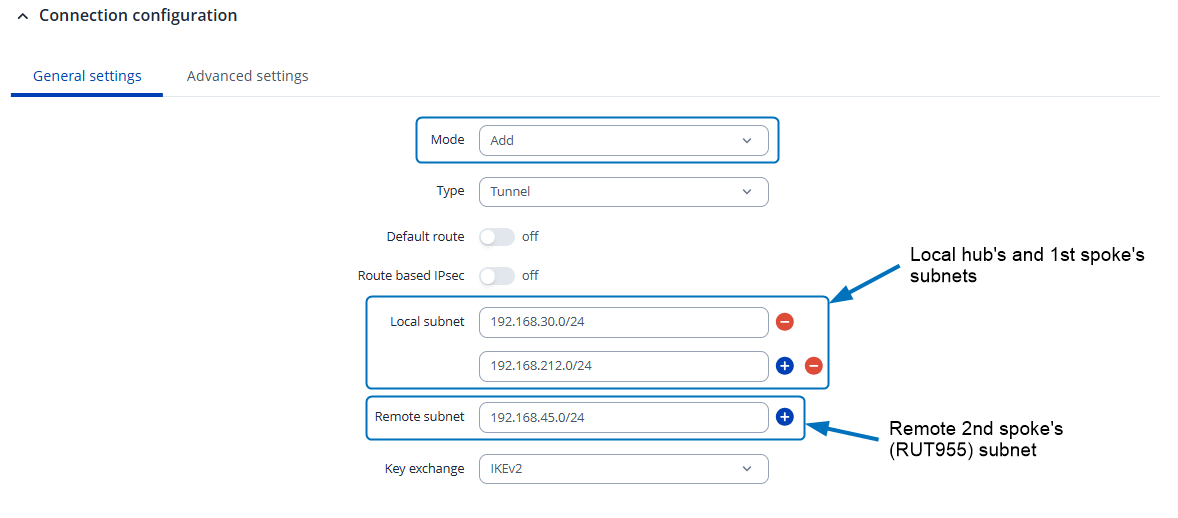

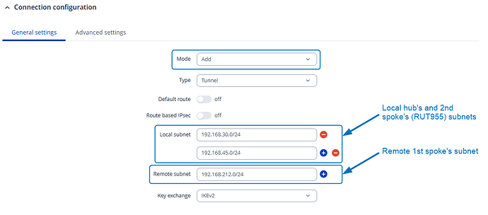

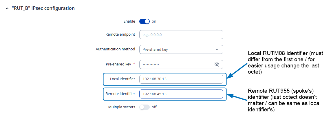

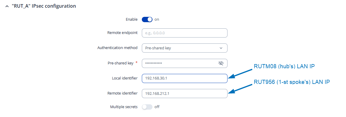

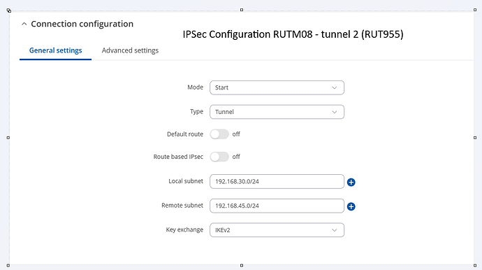

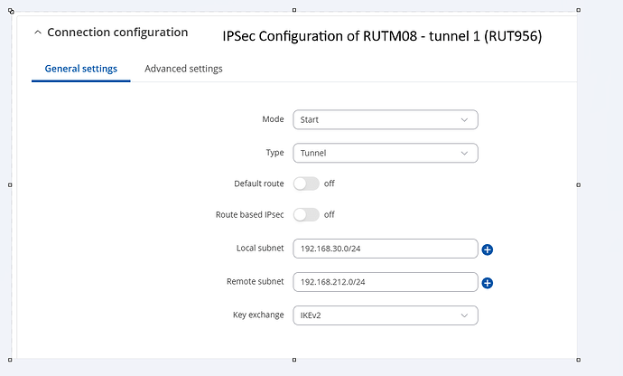

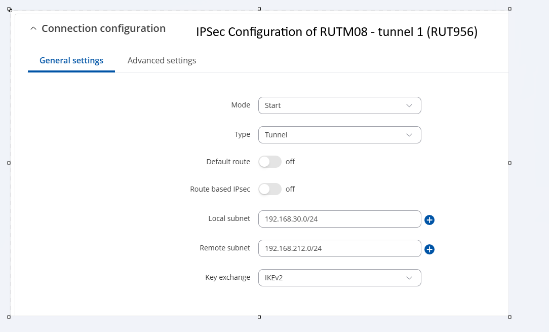

1. On the IPsec hub/server (RUTM08), create two IPsec instances according to the configuration settings shown in the screenshots:
1st (RUT_1) IPsec instance settings
2nd (RUT_2) IPsec instance settings
P.S. ensure Proposal configuration settings match on both instances.

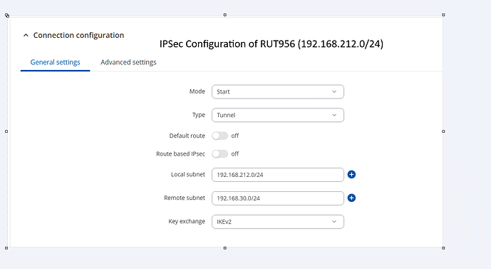

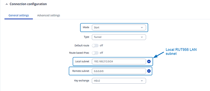

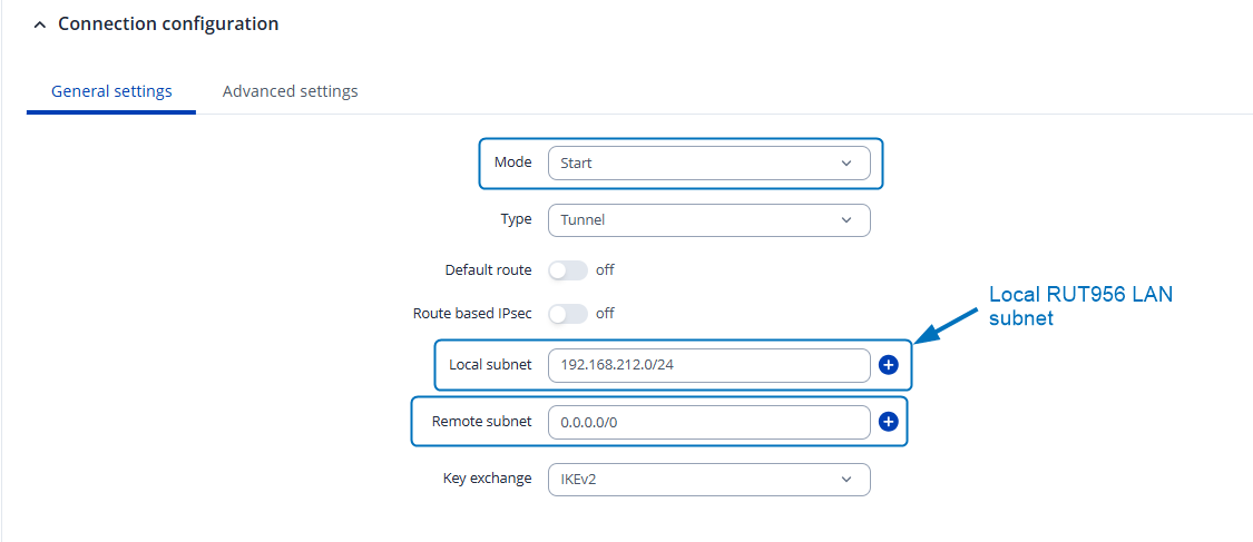

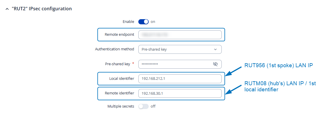

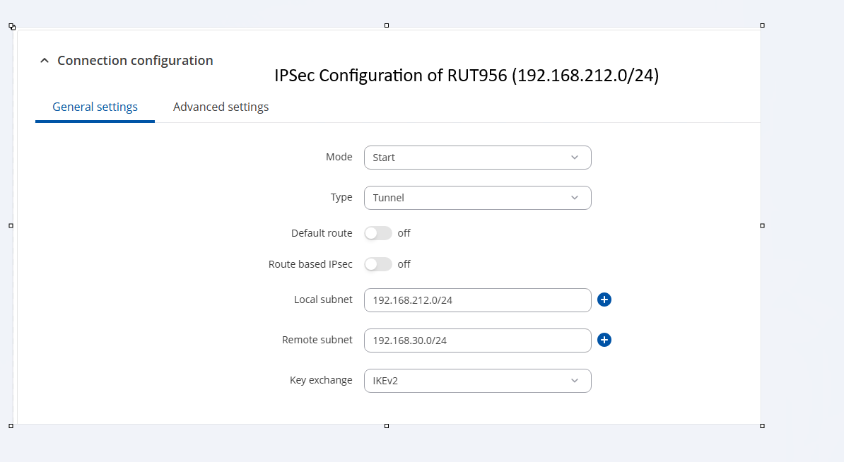

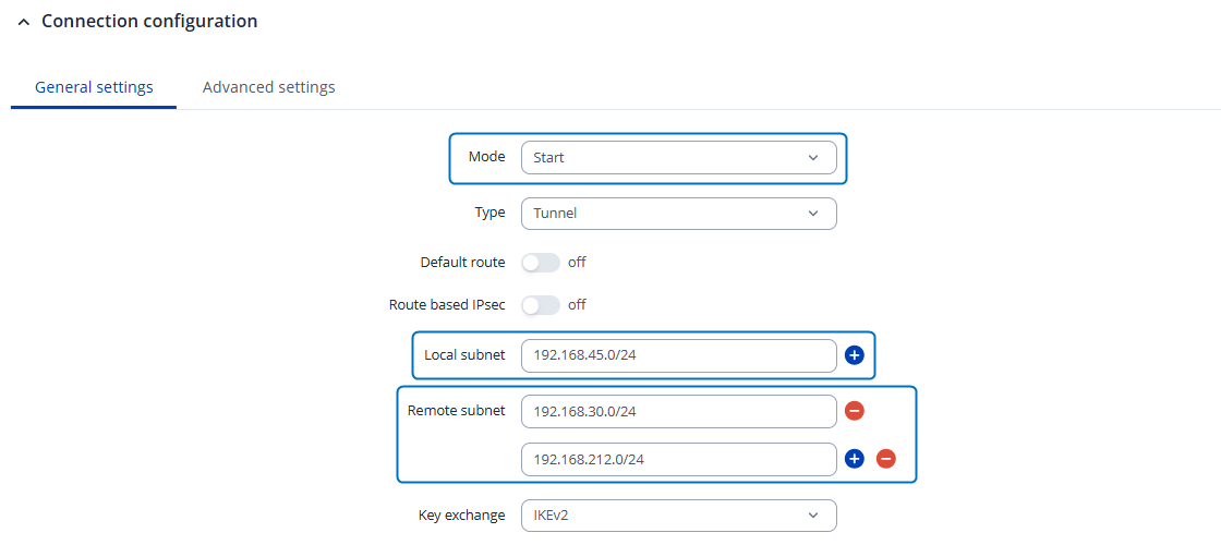

2. Configure the IPsec settings on the first spoke (RUT956) as per the provided screenshots:
1st spokes' IPsec settings
P.S. ensure proposal configuration settings match on both phases.

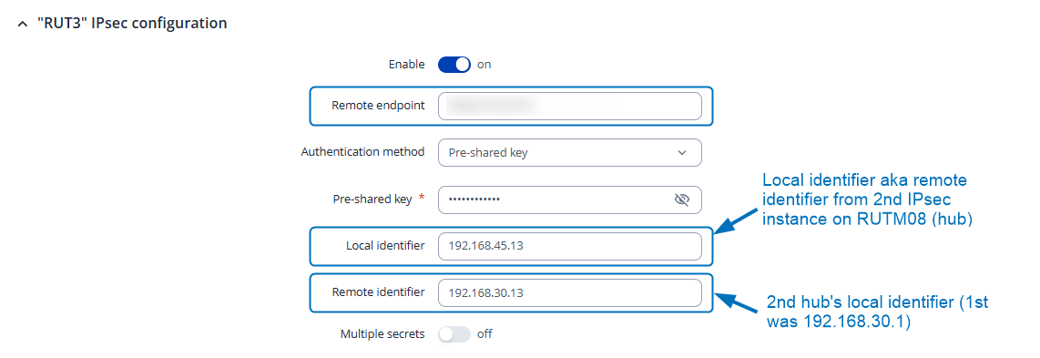

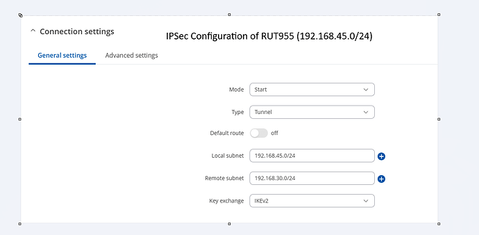

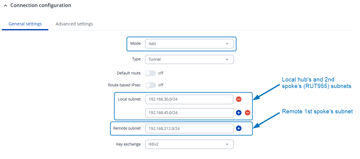

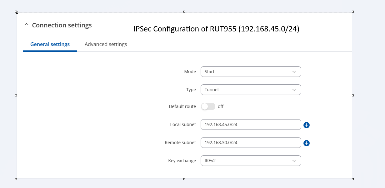

3. Configure the IPsec settings on the second spoke (RUT955) as per the provided screenshots:
2nd spokes' IPsec settings
This configuration doesn’t require adding static routes, however, it is a bit more complex, but at the end, both IPsec spoke’s LAN networks should be able to communicate with each other.
I hope this setup works for you, and if you need assistance or face any difficulties with configurations, feel free to share/reach out here.
