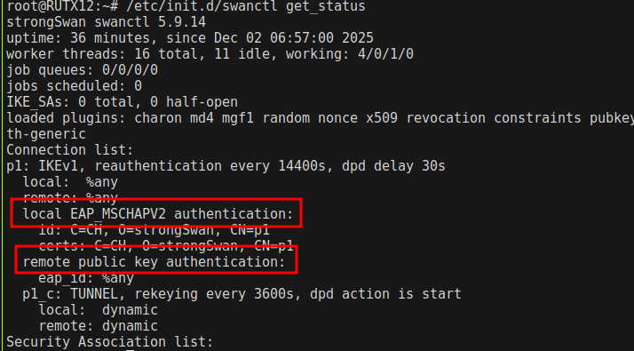

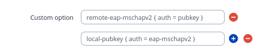

Could you please try using Custom Options?
Thank you, it seems to work, but only if I also add this custom option:
remote-eap-mschapv2 { eap_id = }
(or remove eap_id = %any manually in the generated file).
That’s with version RUT9M_R_00.07.19.4.
That’s great to hear! Thanks for sharing.
