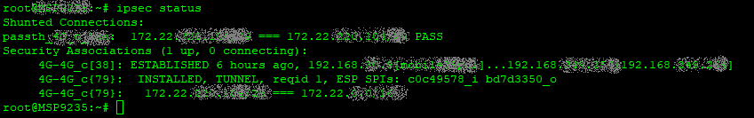

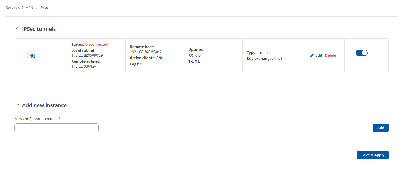

We already experienced this in 7.6.3 on a RUT955 and are still experiencing the issue on RUT955 (FW 7.6.11) and RUT956 (FW 7.6.10).
The issue is that the webui is showing an IPSEC VPN as disconnected, whereas when you check the CLI, it clearly shows the IPSEC VPN as online. This makes troubleshooting a lot of more difficult, as you can’t rely on the webui information.
Is this a known bug and when will this be adressed? A reboot of the RUT95x, changing browsers, etc. does not solve the issue.

This is the case for some of the units, but we also have units that are upgraded to the mass production firmware, factory reset and configured from scratch - the issue is also still visible in these cases.
