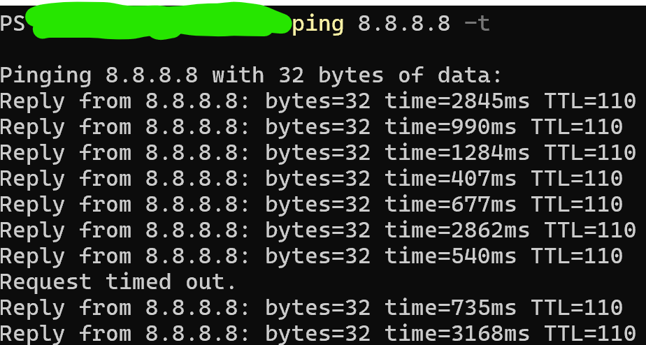

If the route is in this state he has maximum download bandwidth of 5mbits but a quite normal upload bandwith of 50mbits.
The ping response times are then above 2 seconds. This is for most application a not usable internet connection.
The interessting thing is, that a router reboot fixes the problem and brings me back to sub 40ms response times and download speeds above 400mbit.

The fix definitely changed something but didn’t fixed the problem. Here are the new logs that I see:

The following notes to the log:
  • now almost always a reconnect on the modem happens if the IPvx connection is broken
  • The connection is still not stable (and slow)
