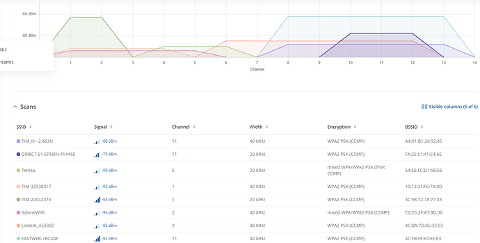

  • Channel: Currently set to Channel 6 (100% utilization).

How does your network setup look? Are your devices all in a wireless mesh, or just completely separate Wi-Fi access points? I believe a topology of your network would help us out a lot here.
Not only are the placements important, but also the kinds of devices that are being used here, are they all Teltonika? What antennas are you using together with our devices?

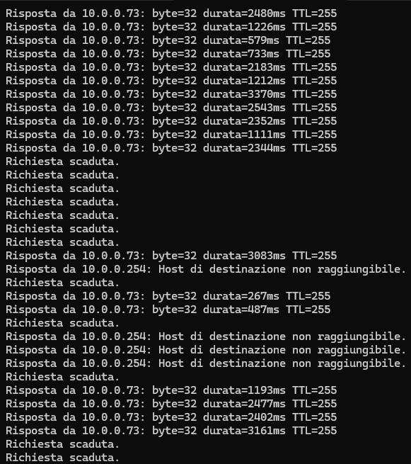

The router is equipped with only the two omnidirectional antennas supplied with it, everything has always worked excellently, I have only enabled access on the 2.4GHz network.
When disconnections occur, I noticed that the degradation is only on the Wi-Fi part, in fact the pings on the ETH nodes maintain minimal latencies.
