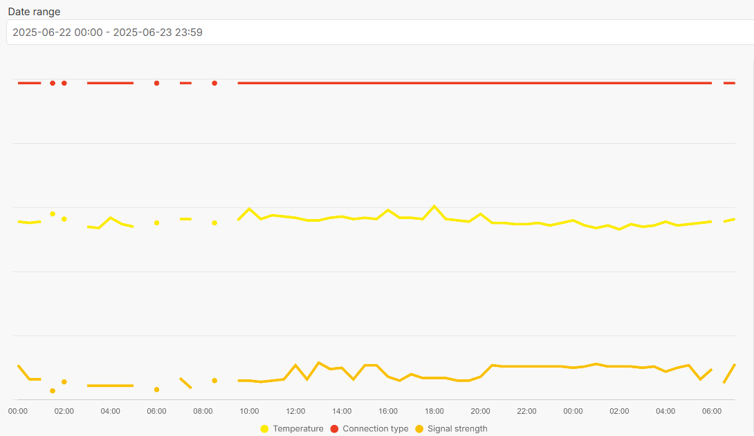

I’d like to clarify one important factor regarding the loss of connection: You say it happens every day, does it happen at the same exact hours as seen in the image? (~2AM, ~6AM, ~8AM)
Do you have anything like an auto-reboot set up on your device? What is the use case for the device, and what environment is it operating in?
If these happen every single day on these specific times, then I believe it should be something configuration-related.

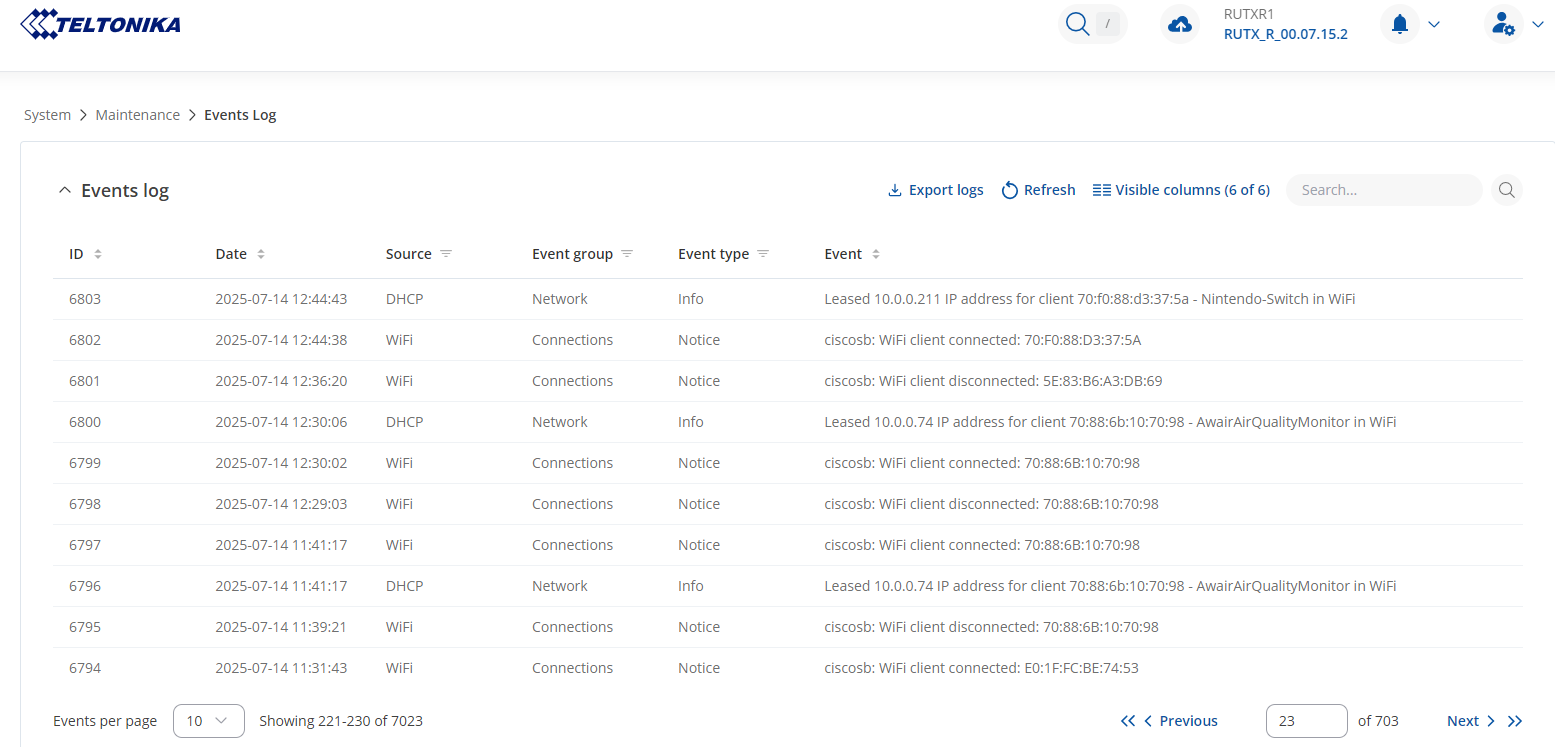

What i have noticed is mutiple events keep occuring and i have no idea what they mean or if its related to the communication issue.

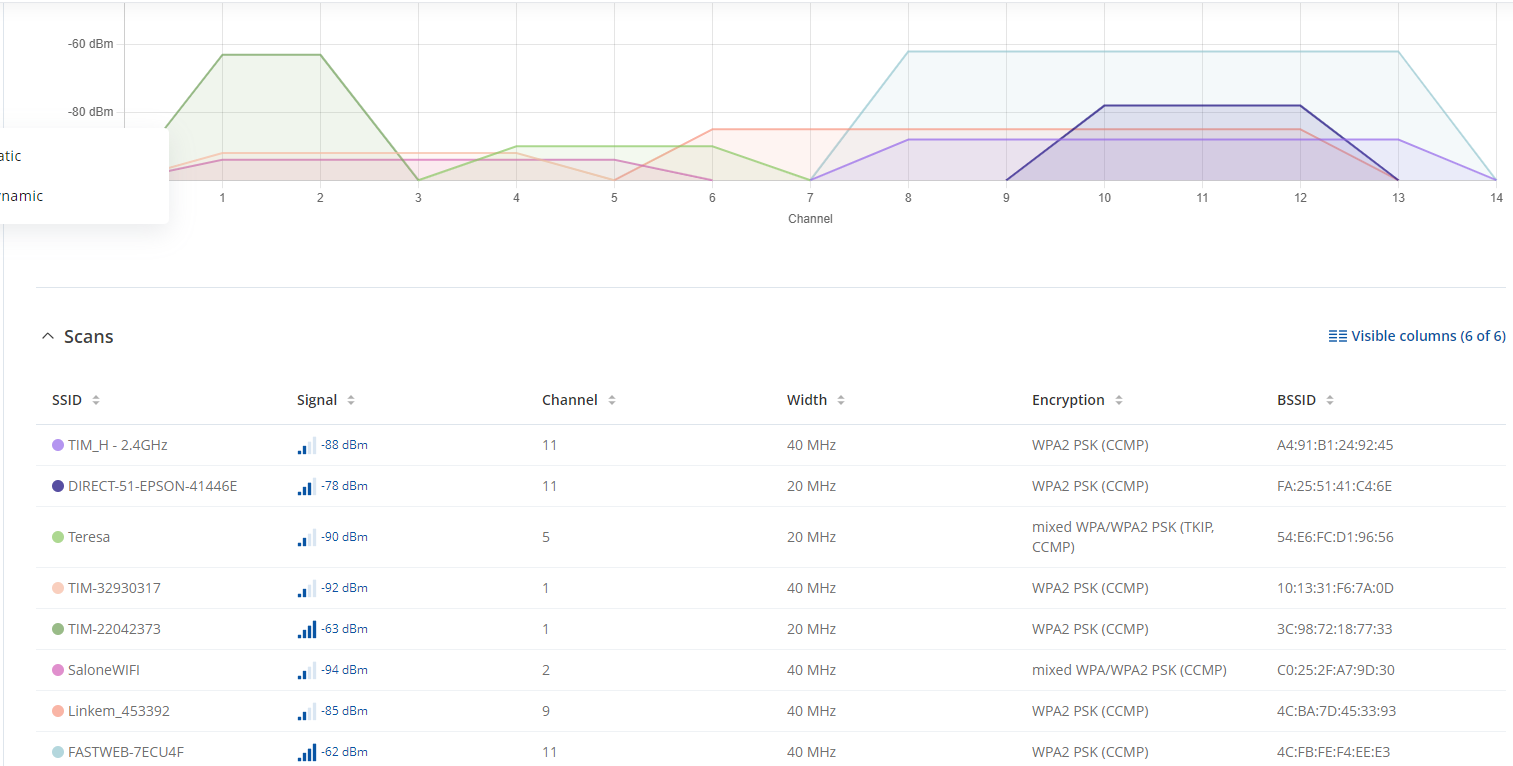

Hi everyone, I’m joining this thread because I’ve been looking for a solution to the poor stability and WiFi issues I’ve been experiencing over the past few weeks. I’ve also tried the solution above, but unfortunately, it’s been unsuccessful. I currently have a dual connection, WAN and LTE, load-balanced (80%, 20%). The device logs show numerous disconnections, even from devices closest to the antennas. The general settings are the default ones, while the selected channel is 6, which is rated 100%.
