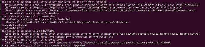

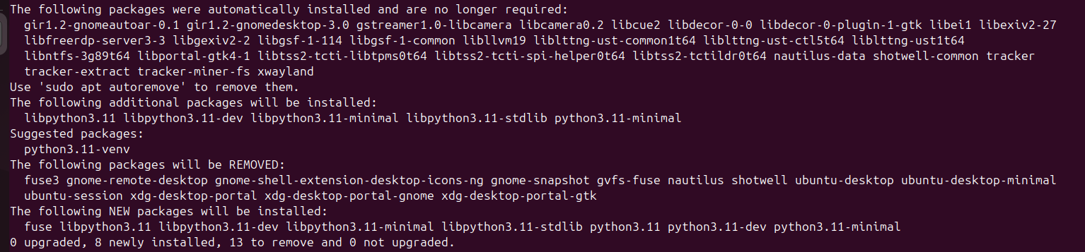

When installing the SDK https://firmware.teltonika-networks.com/7.20.3/RUT2M/RUT2M_R_GPL_00.07.20.3.tar.gz according to the instructions https://wiki.teltonika-networks.com/view/RUTOS_Software_Development_Kit\_(SDK)\_Instruction
the message is reported about the need to uninstall, among others, the package: ubuntu_desktop.
This results in the inability to run Ubuntu in graphical mode after a reset.

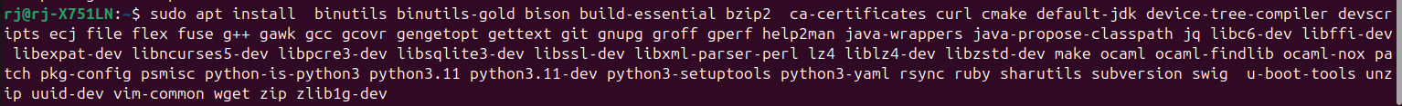

In the meantime, I found a solution:
Should not be installed the fuse package because it uninstalls the fuse3 package, which ubuntu-dektop depends on. Will fuse3 be compatible with the SDK?

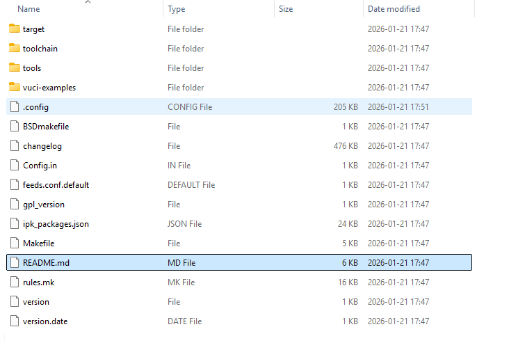

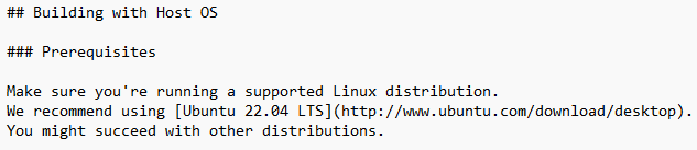

Please build the SDK by following the instructions provided in the README.md file.
If you choose to build on a host operating system, compatibility is guaranteed with Ubuntu 22.04 .
Alternatively, you may use the Docker environment, as described in the README.md.
