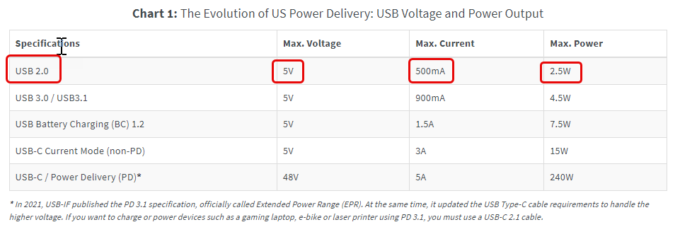

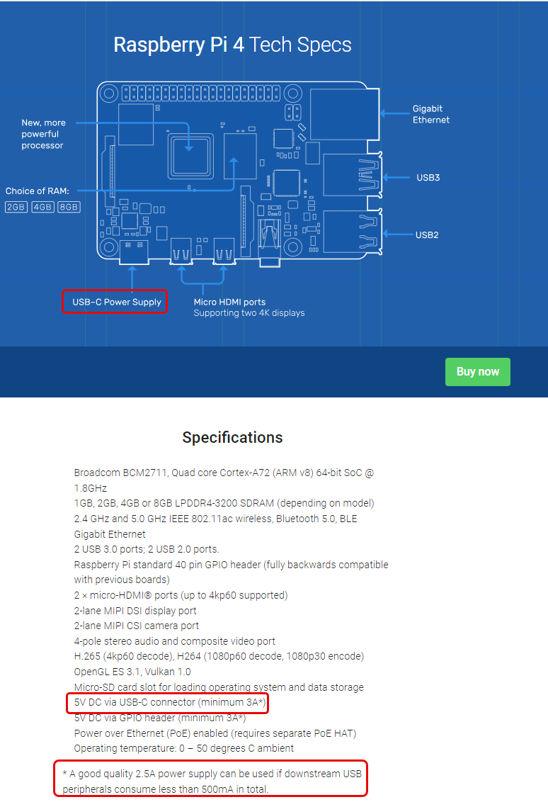

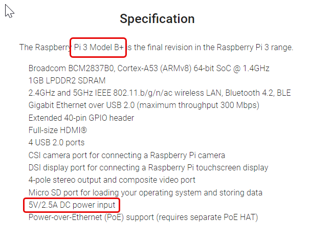

If we are referring to the Raspberry Pi 4 or 3 Model B+ our Micro-usb will not supply enough Amps to power the device. In addition to that our PSU we ship with the device would not supply enough wattage either to power both devices at full power draw.
I am referencing raspberrypi’s website for the following power requirements.
Our TRB140 is part of our Gateway series, and both our Gateway & Router series have devices that can satisfy your other requirements for a SIM WAN connection & LAN DHCP. But currently if you are attempting to power a raspberry pi 3 or 4 from one of our devices you would need a larger PSU that can support both devices.
CAUTION
Our RUTM50 for example comes with a larger 18W PSU that could power on the device. But I would caution to check your usecase for both RUT or TRB devices + Raspberry pi. As some functionality may require more power draw than is possible from our USB 2.0 ports. Additionally our USB ports do not have any surge protection on them, so there would be a chance if the Raspberry pi unit draws too much power it could damage the RUT/TRB board & the Pi itself.
CAUTION
In general the safer recommendation would be to power both devices independently with their ownPSU. Powering a raspberry pi via the USB port would be done at your OWN RISK.
