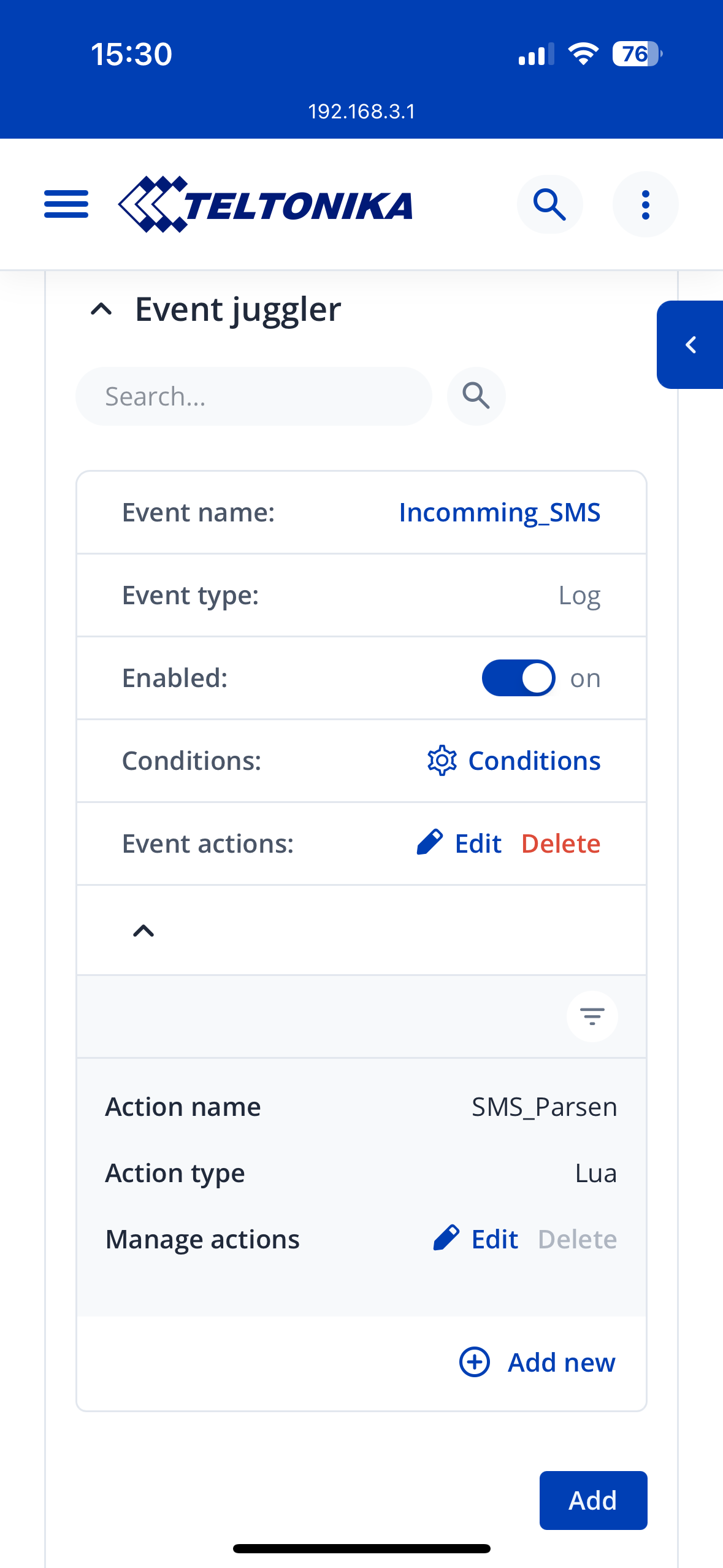

Hello – all right, after a few attempts, I found the trigger for an incoming SMS. I wrote a LUA script that executes a very simple function. I discovered that the event is only triggered once by an incoming SMS; a second (and subsequent) incoming SMS messages are ignored. The only way I could work around this was to disable the event in a subsequent script, re-enable it after a short wait, and perform a reload. Only then are further incoming SMS messages considered. Is there another way?
To better understand the behavior, could you please provide some screenshots of your Event Juggler configuration windows? Thank you.

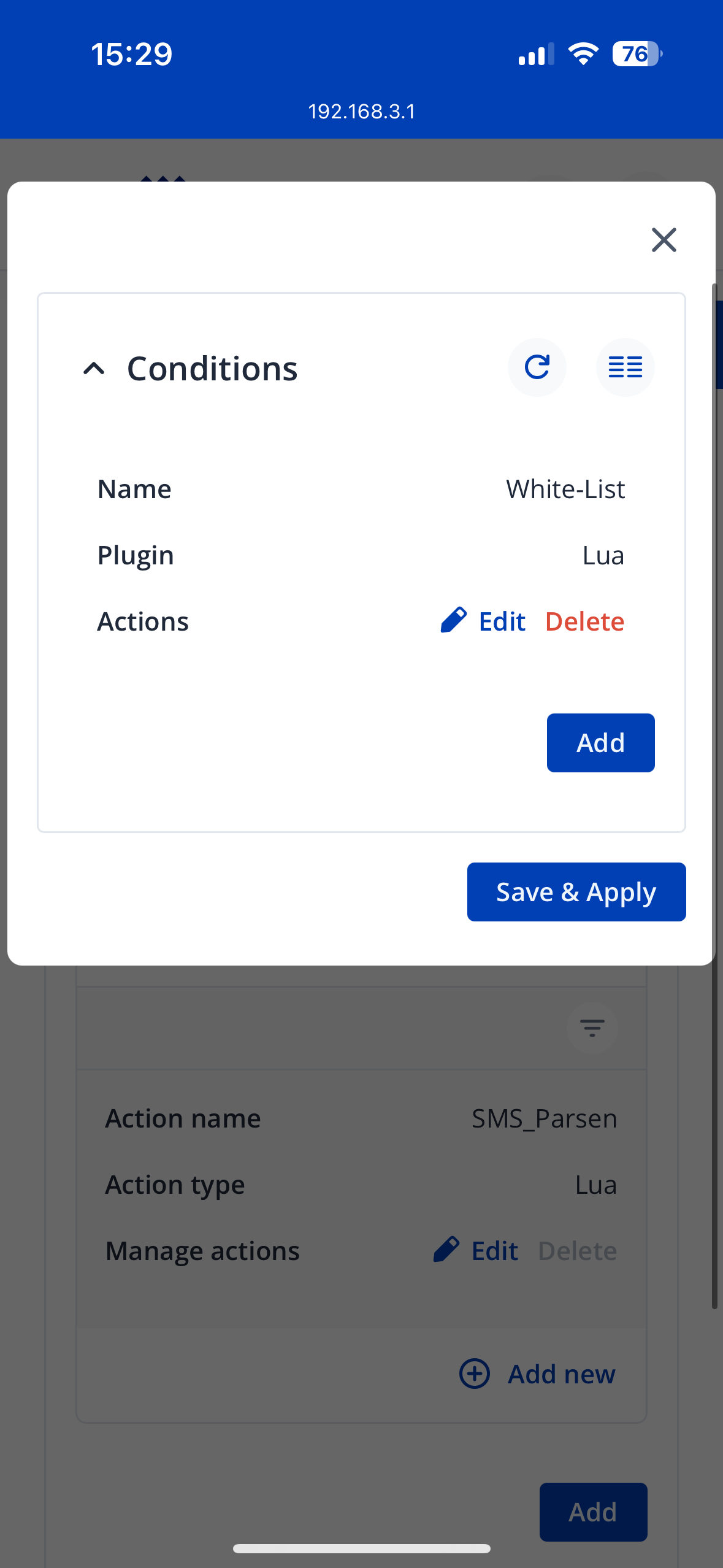

I hope this can help?
Thank you for your update and sharing the screenshots. Could you please clarify what is currently specified in the Condition’s White-List Lua plugin?
Also, have you tried adjusting the parameters, e.g., setting the Trigger interval value to something like 1–5 and the Action’s delay to 1-2, to see if this changes the SMS reading behavior you’ve noticed?
the Condition’s WhiteList check’s via a csv-file if the sender-Cell-No is member of this WhiteList and is allowed to trigger something
I don’t touch the paramters like Trigger-Interval or action delay - I can Check it, if I can trigger a second time my incomming-SMS-Lua-script after a delay, but this is not the reaction, I like to get
