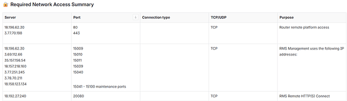

To integrate a RUT240 into a customer’s WAN, the customer’s network must be configured accordingly. Could you please clarify which of the following connections are inbound and which are outbound?
Greetings, idontcare,
Thank you for your question,
These IP addresses are for RMS (Remote Management System) connection. In this case the router will try to access these IP addresses and ports to connect to the system. Because the requests will be sent from the router to the server (RMS), they will be considered outbound from router’s perspective.
Here you can find what IP addresses and ports are used by RMS:
