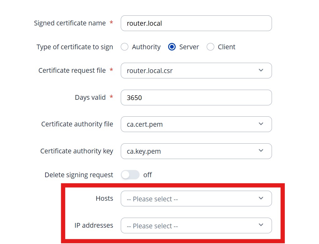

First issue is, if you are making a certificate request that explicitly defines subjectAltNames, it would be nice in the sign dialog, that the fields are prefilled out:
Because it’s a common issue to forget this.
