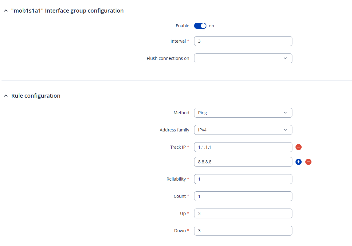

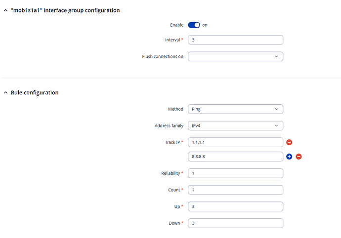

In Network → Failover → MultiWAN → Interface (mob1s1a1), have you modified any settings, or are they all still set to their defaults?
For instance, if you are using the Wget method, it may consume significantly more data, than the Ping

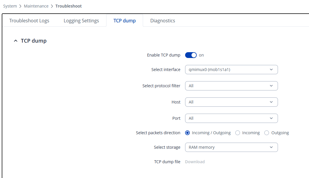

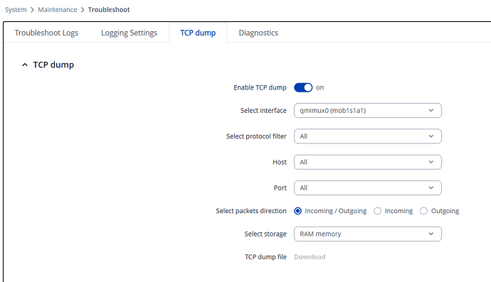

At this stage, it’s difficult to determine the exact cause of the data usage. You would need to capture and analyze the incoming and outgoing traffic on the mobile interface. To do this, navigate to:
System → Maintenance → Troubleshoot → TCP Dump and configure the capture as shown in the screenshot.
After running the capture for some time, you’ll be able to download the .pcap file and analyze the packets (you can use Wireshark for this). This will allow you to review all traffic activity.

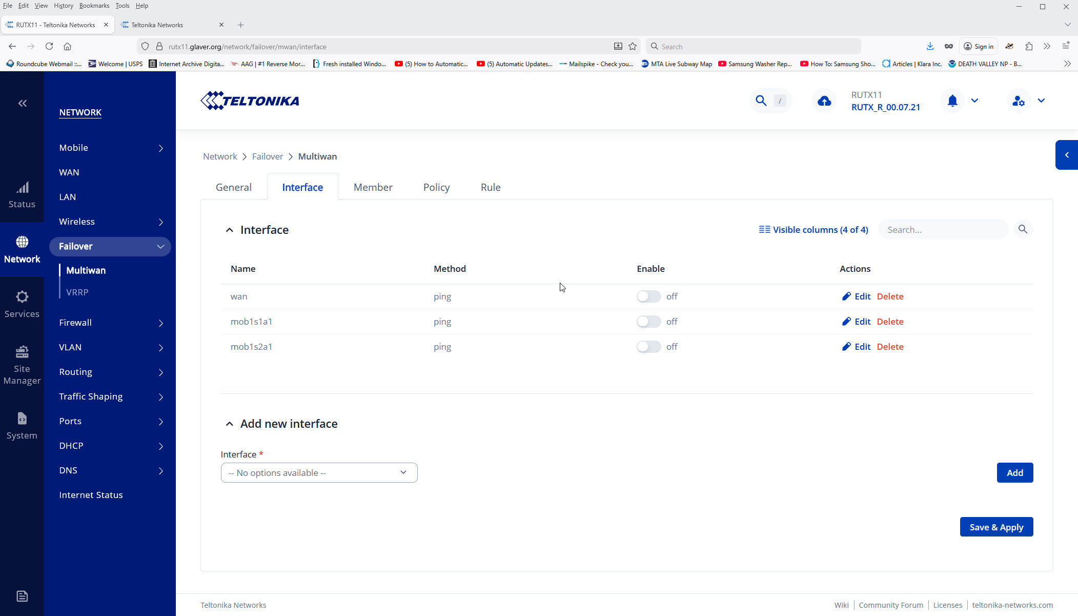

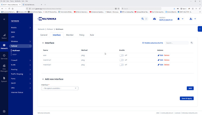

Network / Failover / MultiWAN is completely off:
I should probably enable that…

A tcpdump -i qmimux0 -s 1500 -vv -X showed that all the traffic was IPv6, and seems to be repeated https:// requests to opkg.teltonika-networks.com. every few minutes.
That doesn’t seem normal, but at least now it’s going via IPv4 on my unmetered WAN interface.
