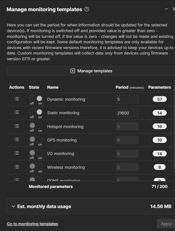

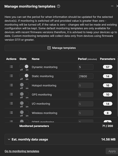

If monitoring is turned on in RMS it does use data even when the device is idle, you can see the estimated monthly data usage when you are editing the monitoring template
Select the device, click Actions → Management → Manage monitoring templates
Here you can see the estimated monthly usage based on your monitoring selections
If monitoring is completely turned off, but the device is connected to RMS, it sends keep-alive pings to the device, which uses around 0.4MB per day (16.41 KB Hourly).
