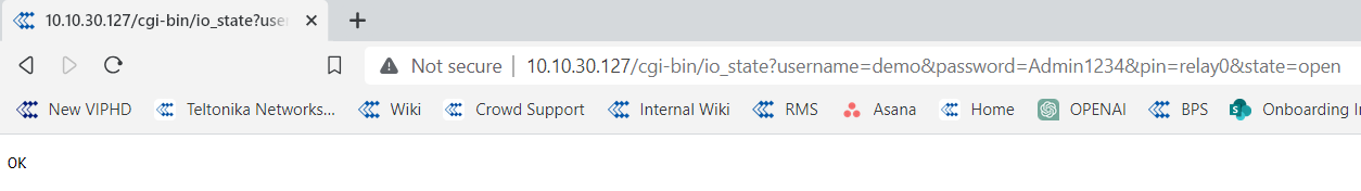

It is highly recommended to upgrade to the latest firmware version as user interface has been improved and existing bugs were fixed. Please refer HERE for FW upgrades.
Specific logs related can be seen through CLI using the following commands. logread To see all logs of the device
logread -f To see real time logs
To enable/disable I/O Juggler, go to Services → Input/Output → I/O Juggler
