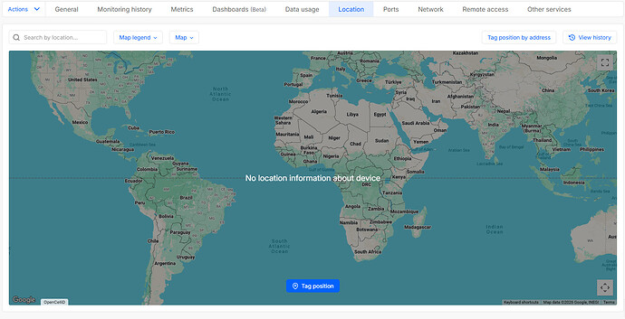

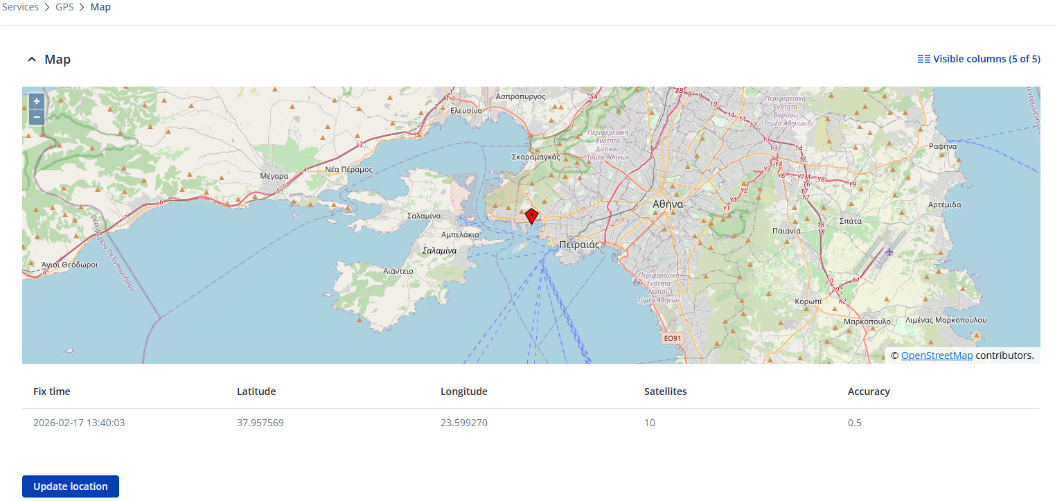

I can see the location of the RUTx50 in its web UI but it does not show it in RMS
Hello, could you please assist on the following? I can see the location of the RUTx50 in its web UI but it does not show it in RMS. What am i missing?

Could you please provide screenshots of the output you are seeing in the device’s WebUI and the RMS system? This will give me additional information needed for further investigation.
I look forward to your reply.
Best wishes,
Hello Vilius. Thank you for your reply. I am attaching the screenshots. Best regards.

Here is a short summary of our remote session.
The GPS location was not visible in RMS because GPS monitoring was disabled on the device. During the session, we enabled GPS monitoring and the issue was resolved. As the problem has now been addressed, I will proceed with closing this ticket.
