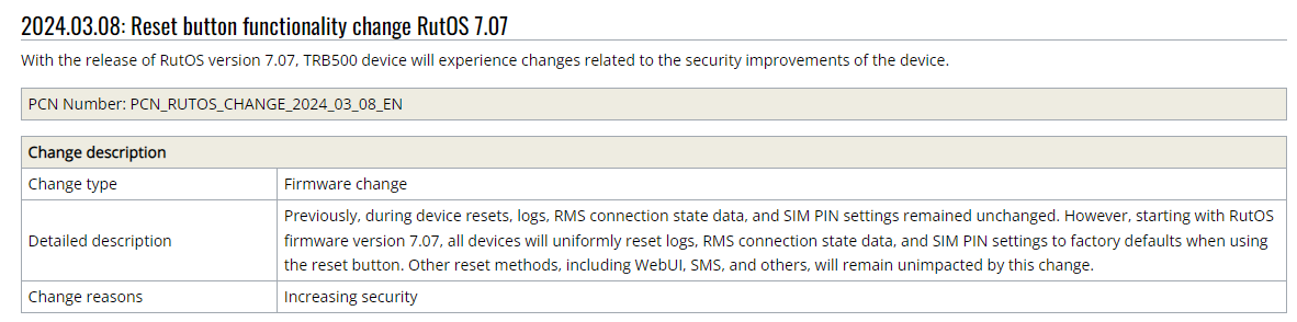

Hello. I want the same, how the question from Option not to remember pin after the factory reset? for higher security. In my case for an TRB500 modem. Is a Custom script*, an solution? But exist a event in the case of Factory reset is starting? And then what is the command to set SIM PIN on zero or none?
Under https://wiki.teltonika-networks.com/view/TRB500_Device_Recovery_Options#Factory_reset stand
Additional note: SIM PIN on the main SIM card is the only user parameter that is kept after a factory reset.
* = TRB500_Custom_Scripts.
Thank you for taking note that.
See here - when you run firmware 07.07.1 and greater, SIM pin will be safely deleted when using the reset button.
And only reset button!
TRB500 Product Change Notifications - Teltonika Networks Wiki
[ 2024.03.08: Reset button functionality change RutOS 7.07]
I recommend updating your TRB500 to the newest firmware version, TRB500_R_00.07.07.1. This update allows you to choose whether to reset the router with PIN and some other settings saved, or to fully reset it to defaults when completing a factory reset.
