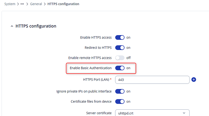

Could you please confirm whether Basic Authentication is enabled?
You can verify this by navigating to System → Administration → Access Control, then clicking Edit under HTTPS, where the setting will be displayed.
