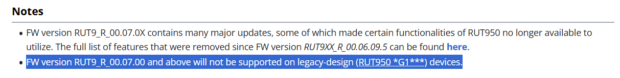

Regarding upgrading - it depends on which firmware you want to upgrade to, would it be the latest legacy or the latest normal firmware? Since your device sounds to be very old, I would presume that at best, you’d be able to upgrade to the latest legacy firmware, due to some limitations with older devices not being able to upgrade to the normal firmware:
If your device product code contains G1, then this is likely the case for you.

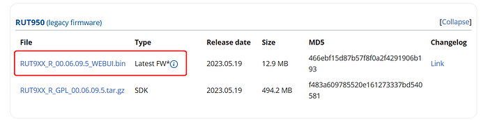

What you need to do then is simply head to our firmware download page: RUT950 Firmware Downloads - Teltonika Networks Wiki
And download the latest legacy firmware file:

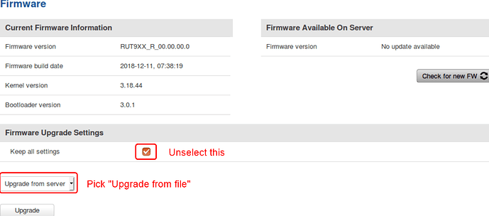

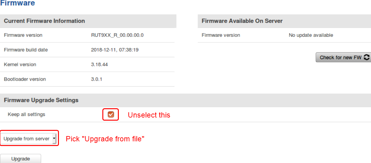

You should then proceed with logging into your device’s web interface, heading to System → Firmware → Update Firmware:
And simply upload your file - since we’re unchecking “keep all settings”, all of our configurations, passwords, etc. will be erased. We’re doing this due to the fact that we’re making a jump from an old major version, to the latest, and we’d like to avoid any migration-related issues.
