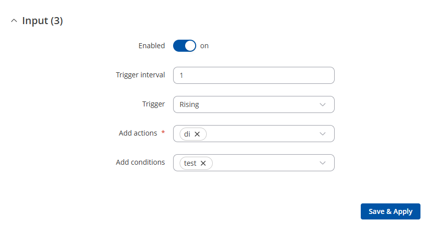

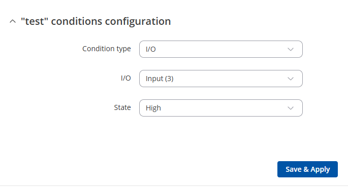

I have tested the setup where when input (3) is high, the device executes a script, and in the logs, the word “test” is displayed. Below are my configurations:
Conditions:

General:
Script:

Please update your device to the latest RutOS version and try configuring your settings by following the screenshots I provided. Let me know how it goes and if you still require further assistance.
