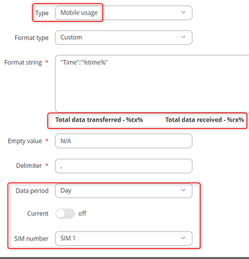

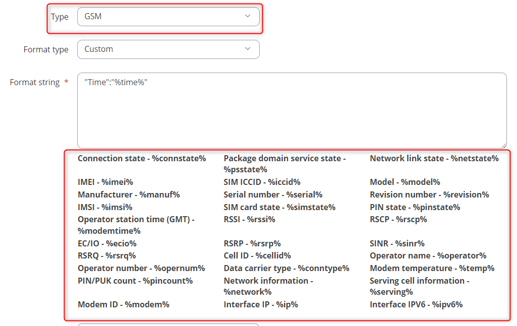

I would suggest taking a look at data to server here. It is possible to send GSM and Mobile usage data to your broker over MQTT periodically without any additional scripts:

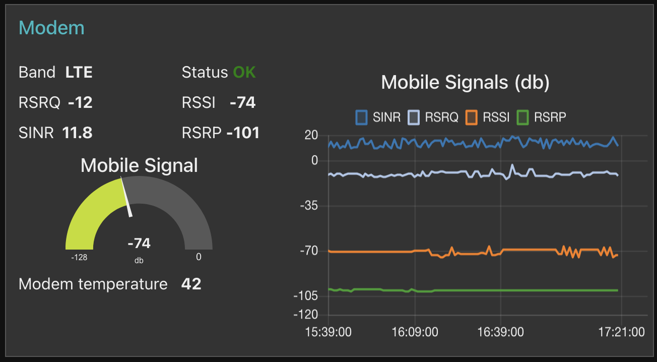

I am now using a small script run every minute under cron to pull LTE staus using ‘gsmctl -E’ and send to my server with MQTT.

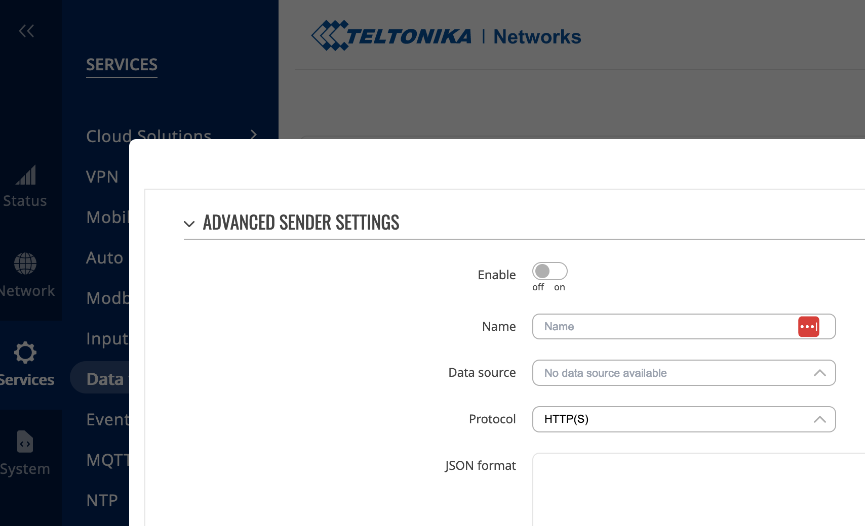

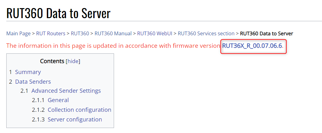

In order to see if your solution was better than mine, I just spent an hour looking everywhere for the Data to Server menu option - it would have been helpful if you had mentioned it is a package that needs to be installed in the RUT360.

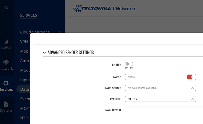

Now I have Data to Server entry, and tried to Add a Data Sender. The menu looks nothing like either your post or the RUT360_Data_to_Sender page, and there are “No data sources available”.
At this time I’m giving up on your recommended solution as your instructions are either unclear of for a different device?
Thanks anyway.
From the image, it seems that you are using an older firmware version.
If you would like to use new data to server functionalities, you will need to update the firmware of you device. The latest firmware for RUT360 can be downloaded from here. However, if you decide to update the device, please keep in mind that since your current firmware is at least 2 major releases older than the latest version, the recommendation is to update the device with ‘keep settings’ option disabled to avoid any potential migration issues. This means your current configurations, including third-party files like scripts, will be erased, but it will ensure a smooth update process.

I set up ‘Data to Server’ Type: GSM, Format type: json and am getting the data I require without any other customization.

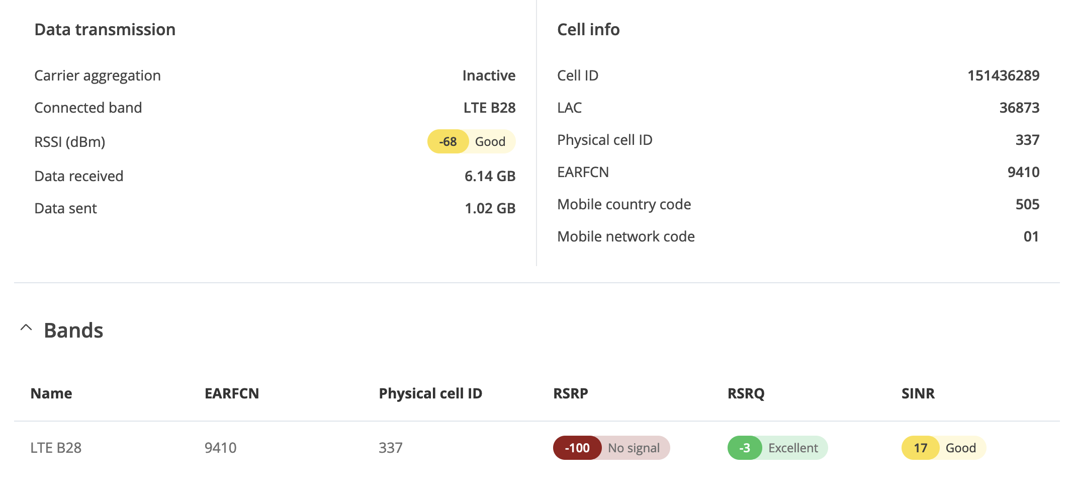

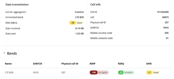

The only question I have now is why does RSRP always say ‘No Signal’ on LTE?
Steve
Glad to hear that it is working properly now!
The red ‘no signal’ RSRP value in the WebUI simply indicates that the RSRP of your cellular signal is poor. I recommend checking our articles here and here to learn more about it.
