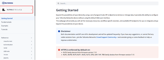

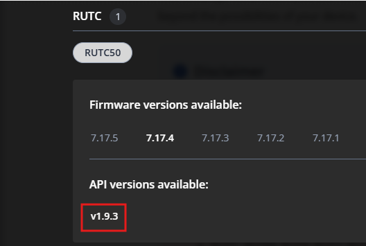

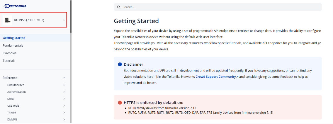

It’s a JSON file, you can open it with Notepad or some other text editor. At the start of the file you can see the version (this is the API version) and firmware. Edit the firmware to the newer one and the API version to the one listed here: https://developers.teltonika-networks.com/
If the API version is, for example, 1.10, in the file you have to write 1.10.0
