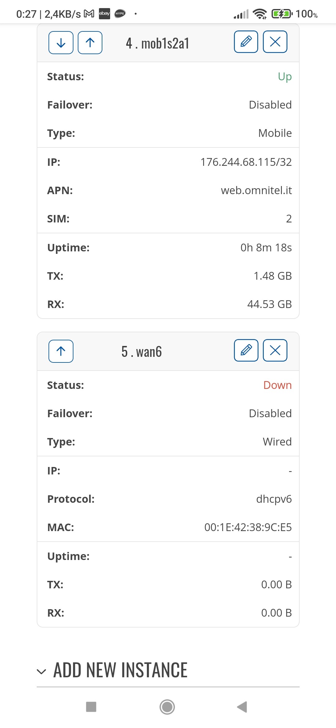

root@teltonika129:~# ip -4 route add engage.cloudflareclient.com dev mob1s2a1 metric 0
Error: inet prefix is expected rather than "engage.cloudflareclient.com".

root@teltonika129:~# ip -4 route add 162.159.192.1/32 dev mob1s2a1 metric 0
Cannot find device "mob1s2a1"
The device is probably mob1s1a1 if you have only one sim.
