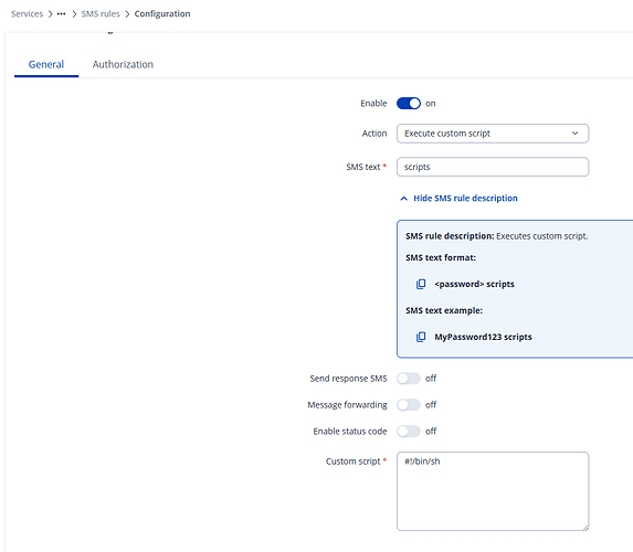

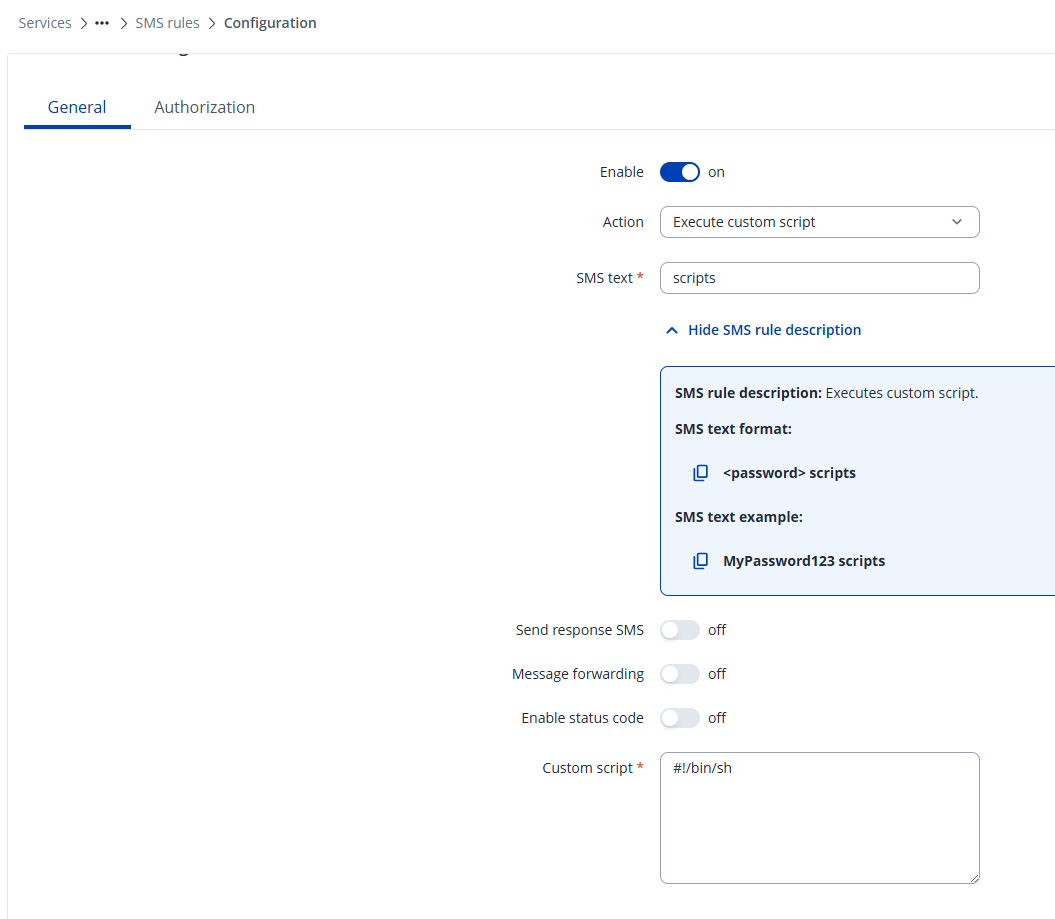

Unfortunately, this feature is not currently supported. However, there are several possible workarounds, depending on the SMS commands you are using.
If you are sending SMS commands to monitor status changes, you can configure Event Juggler to send an email whenever a specific event occurs. More information can be found here: RUT200 Event Juggler - Teltonika Networks Wiki
Alternatively, you can use our Remote Management System (RMS), which does not require a public IP address. RMS allows you to manage devices whenever they have an internet connection, including changing settings, accessing devices remotely, and performing other management tasks. More information is available here: RMS - Teltonika Networks Wiki
If you need to trigger a command via SMS but require the response to be delivered by email, you can create a custom SMS Utility script that gathers the required system information and sends it via email
For guidance on sending emails from a script, please refer to the article here: Sending emails via command line - Teltonika Networks Wiki
Scripts examples can be found here: User Scripts examples - Teltonika Networks Wiki
