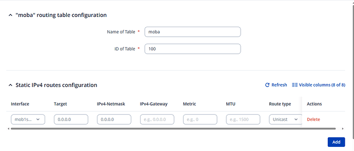

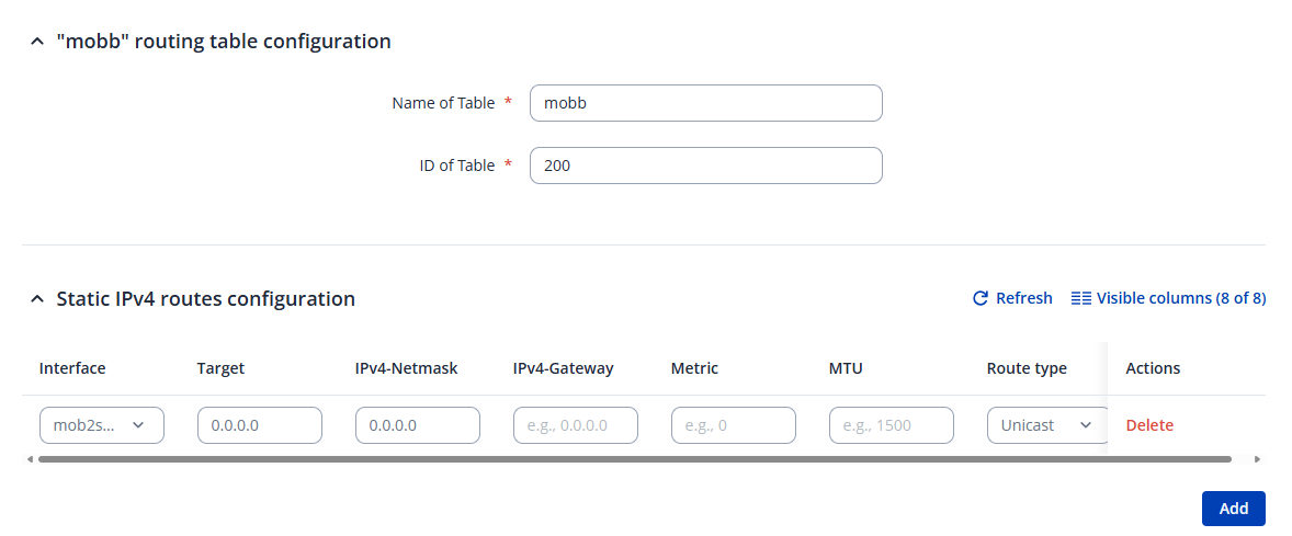

Create two new instances, one for each WAN interface. Enter the ID, configuration name, and click Add.

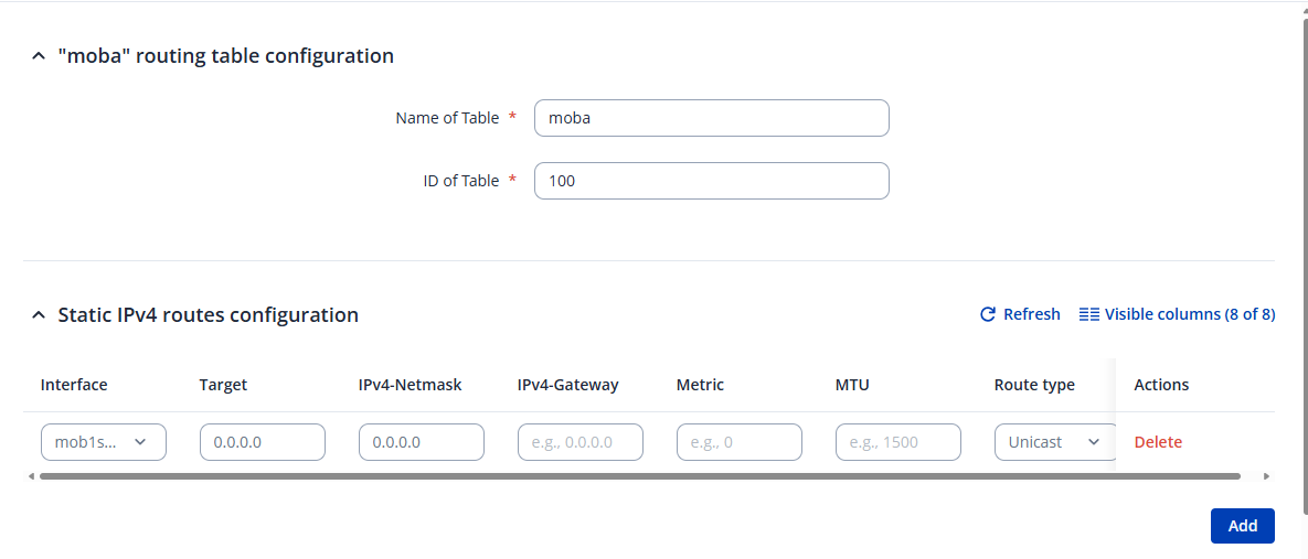

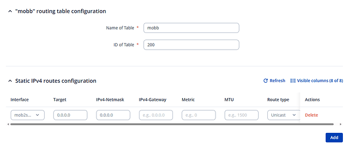

In the example below, I’m using two mobile interfaces (WAN1 as the main interface). If your setup is the same, there’s no need to specify the gateway. Configure the new routing tables as shown in the screenshots: shown in the pictures.

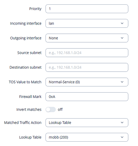

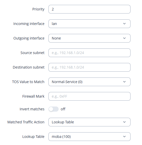

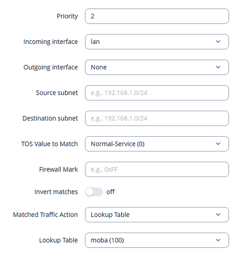

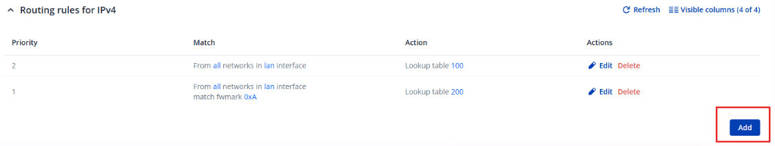

Next, add two routing rules under Network → Routing → Rules.
Again, configure them as shown in the examples below. Remember to specify the Firewall Mark in the routing rule that selects the WAN2 interface table.
