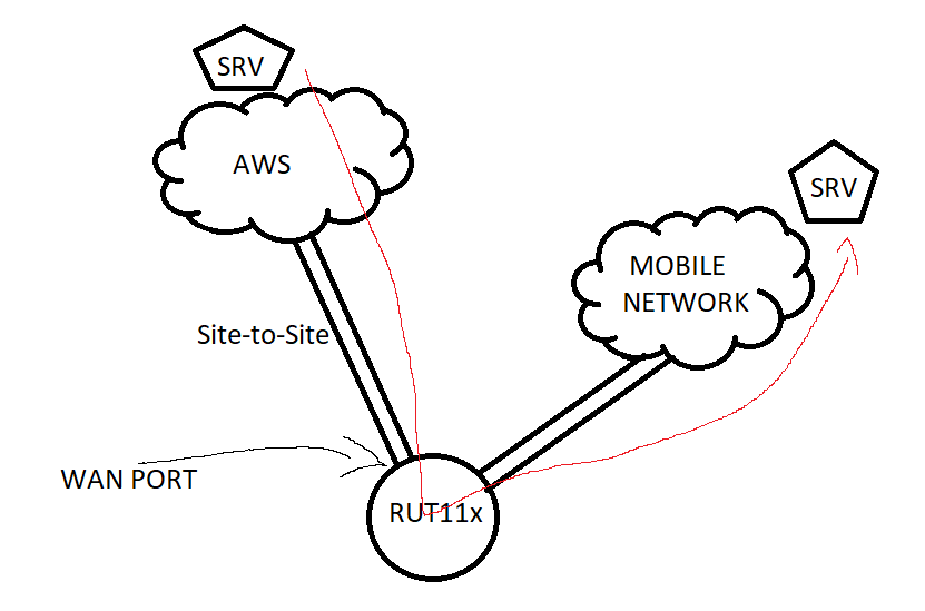

I have a site-to-site vpn from AWS to my teltonika router Rut11x, i need to let a host from AWS to go througth internet via the teltonika router to get a service that can only be reachvia the teltonika router.
The VPN is al ready up and i can access AWS from the LAN of the teltonika but now i need a Server on the AWS side to go througth the mobile netwrok to a service.
the VPN is passing via the copper WAN port and the Service that i need to reach is over the WAN MOBILE PORT, i have all ready created added a firewall rule to permit the trafffico from the VPN to go to the wan but apparently it does not nat the AWS server ip before sending the traffic is there a way to do this?

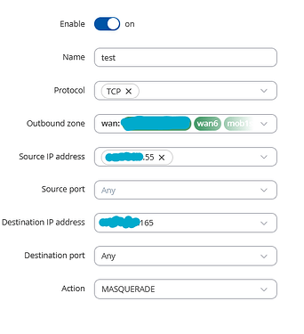

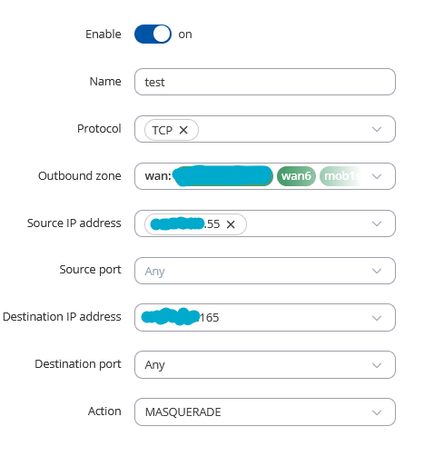

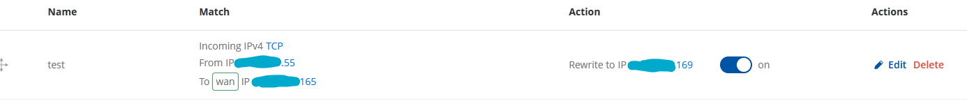

this is the nat rule>
i did it with mascarade.

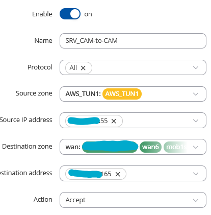

and this is the firewall rule>
that what i had but i change the nat with mascarade insted of SNAT, but still the AWS SRV cant reach the server on the mobile network.
does the configuration makes sense?
