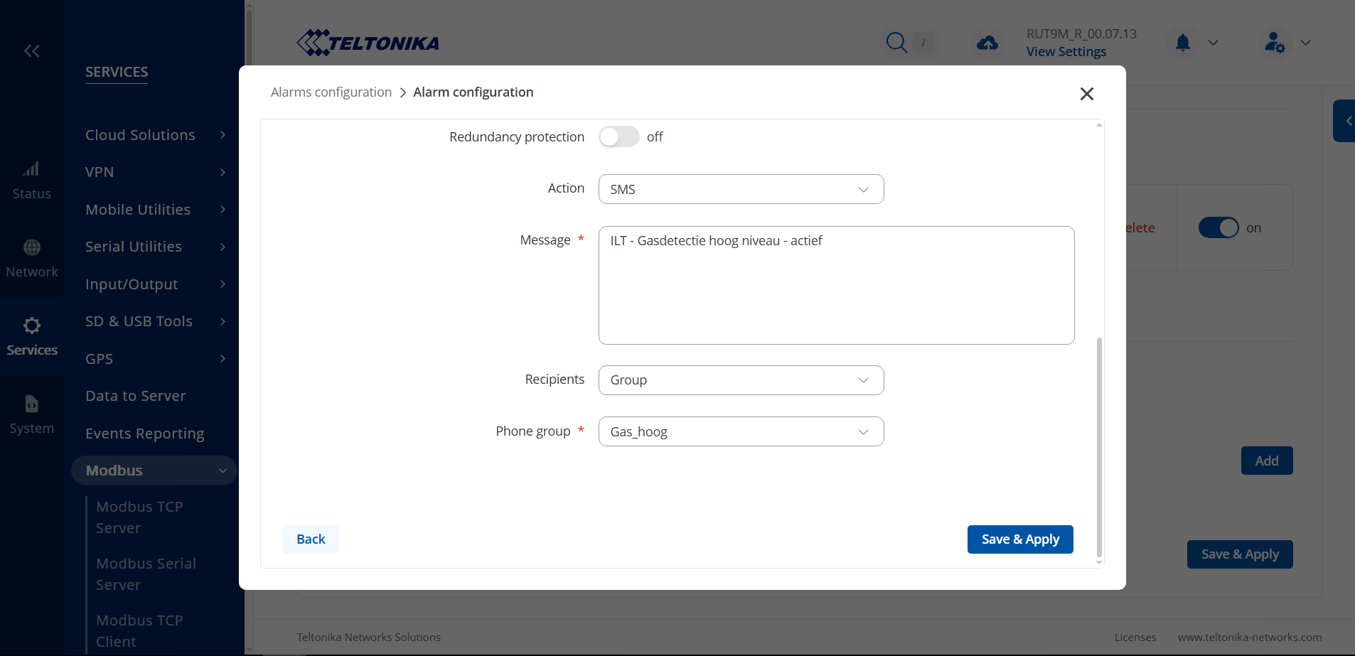

How to Insert Timestamp in SMS Action Field for Alarms in Teltonika Modbus Configuration?
We want to include the time in the SMS message sent from our Teltonika device under Modbus → Alarms Configuration, specifically in the Action field. However, when we use [time], the SMS literally shows “[time]” instead of the actual time. How can we fix this?
Currently, there is no argument or variable available to include a timestamp in the SMS message sent from the Modbus alarms.
If a timestamp is essential for your setup, please note that timestamps are supported in the email sending action for Modbus alarms.
For SMS timestamp support to be implemented, it would require going through the MBP/CDP procedure. If this is a necessary feature for your application, you should reach out to your sales manager to discuss the possible path.
