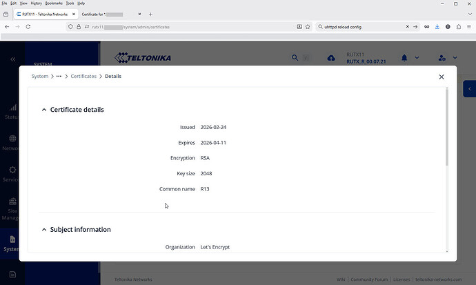

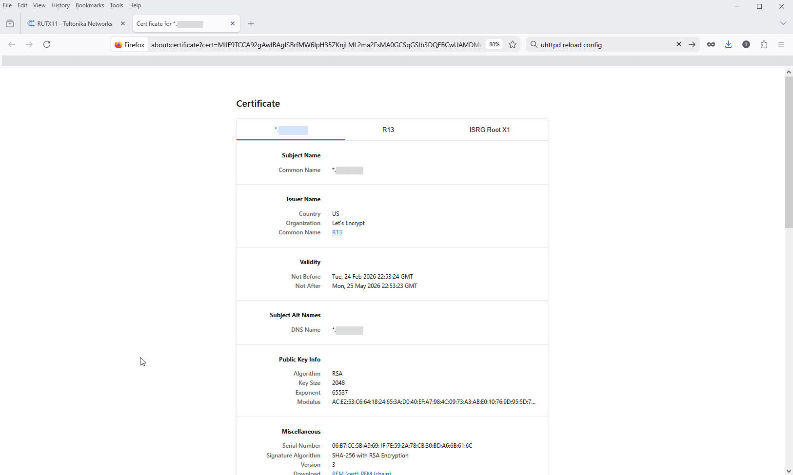

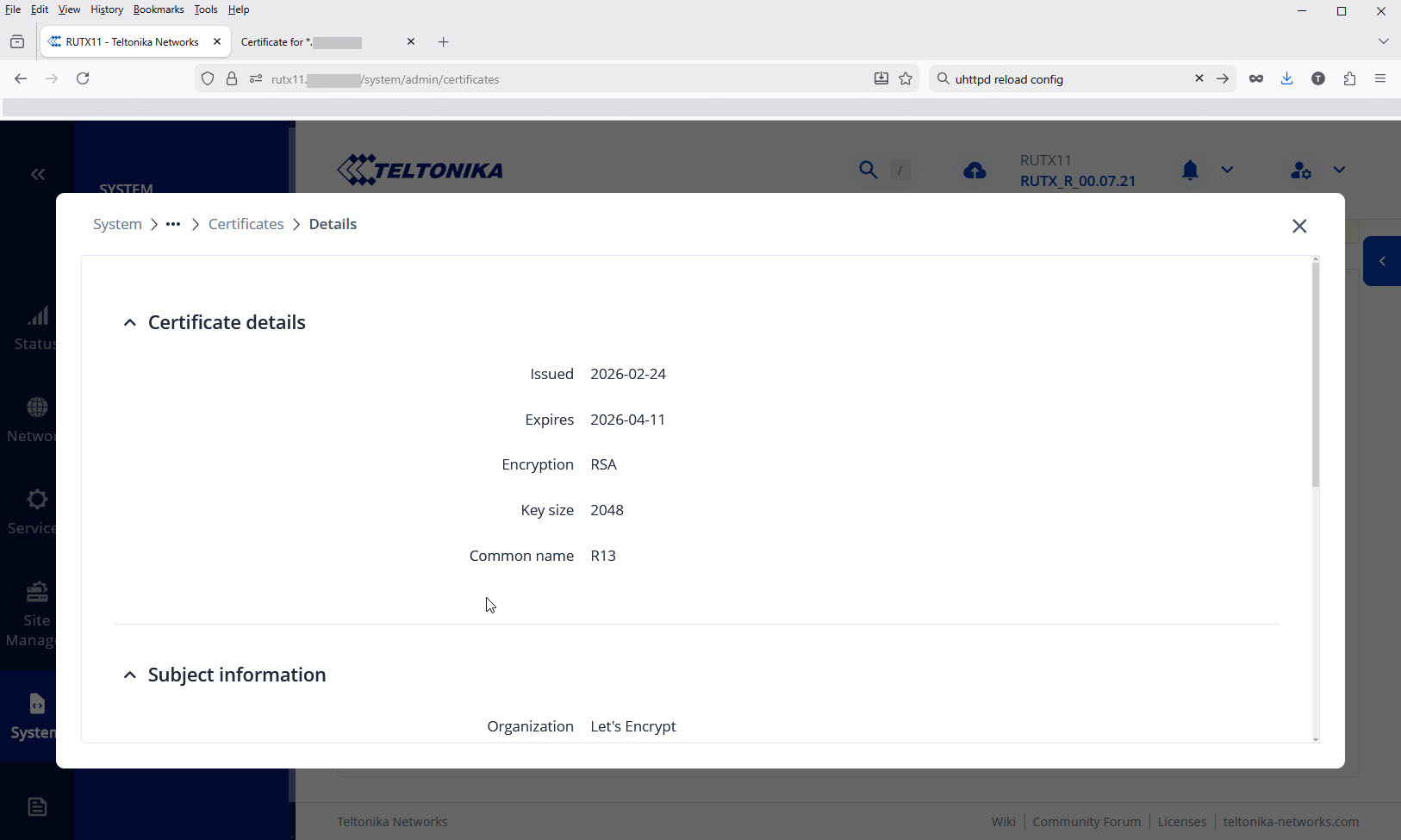

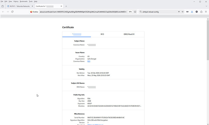

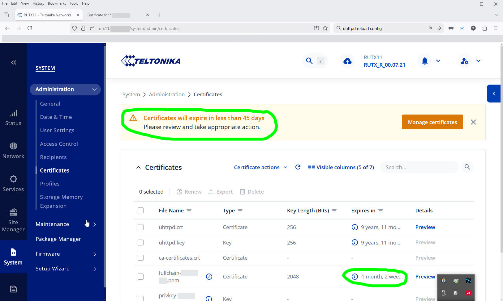

However, the RUTX11 Web UI is still reporting “Certificates will expire in less than 45 days” even after a reboot of the device, and the certificate information shown in the UI page is incorrect (it shows the new issue date, but not the new end date). Note that the certificate expiration as shown in my browser (second picture) shows the correct expiration of 25 May.
Is there some CLI routine I have to call to have RutOS either “notice” that the certificate has been replaced, or to actually install the replacement certificate? I found cert-install-vuci but it isn’t obvious if that is the correct file or what parameters it takes.
However, the correct certificate issue date and expiration is shown by the browser:
And the Web UI shows the correct issue date, but the wrong expiration date:

Regarding the certificates, you can upload them manually through the WebUI by navigating to System → Administration → Certificates, then selecting Certificate Actions and clicking Import.
