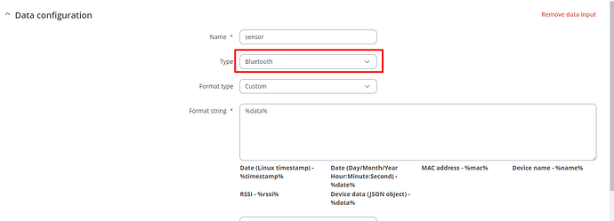

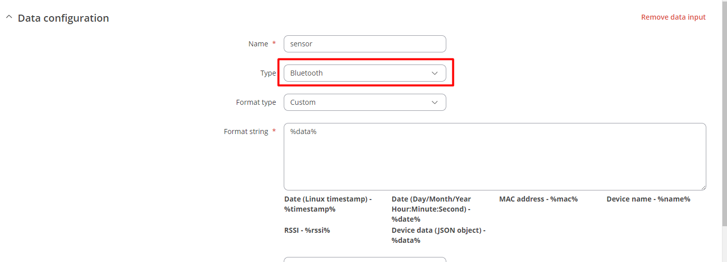

In your case however, eye sensor data can be sent through Data to Server functionality. Navigate to ServiceData to Server.
Create a data input choosing ‘Bluetooth’ as the type.

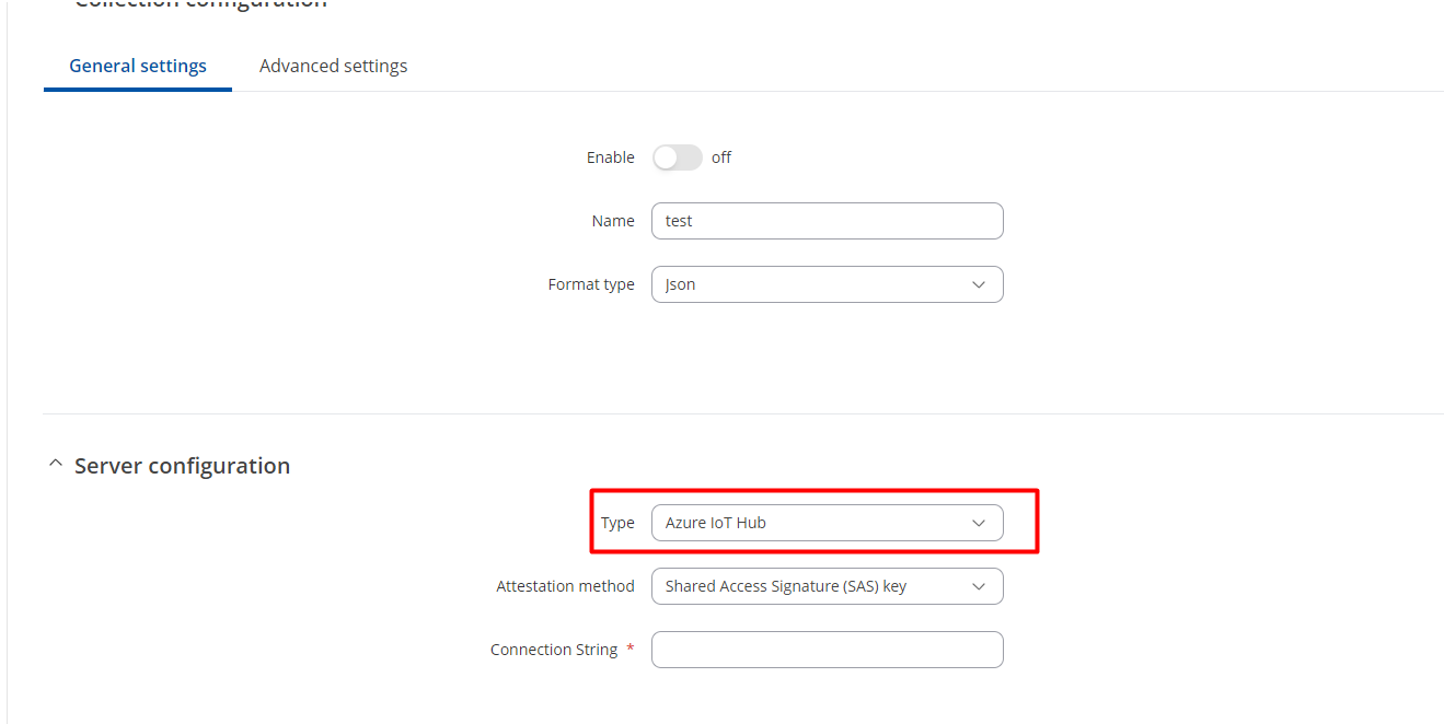

Then in the server configuration, you can select the ‘Azure IoT Hub’ option then configure the connection string (if SAS key is chosen).

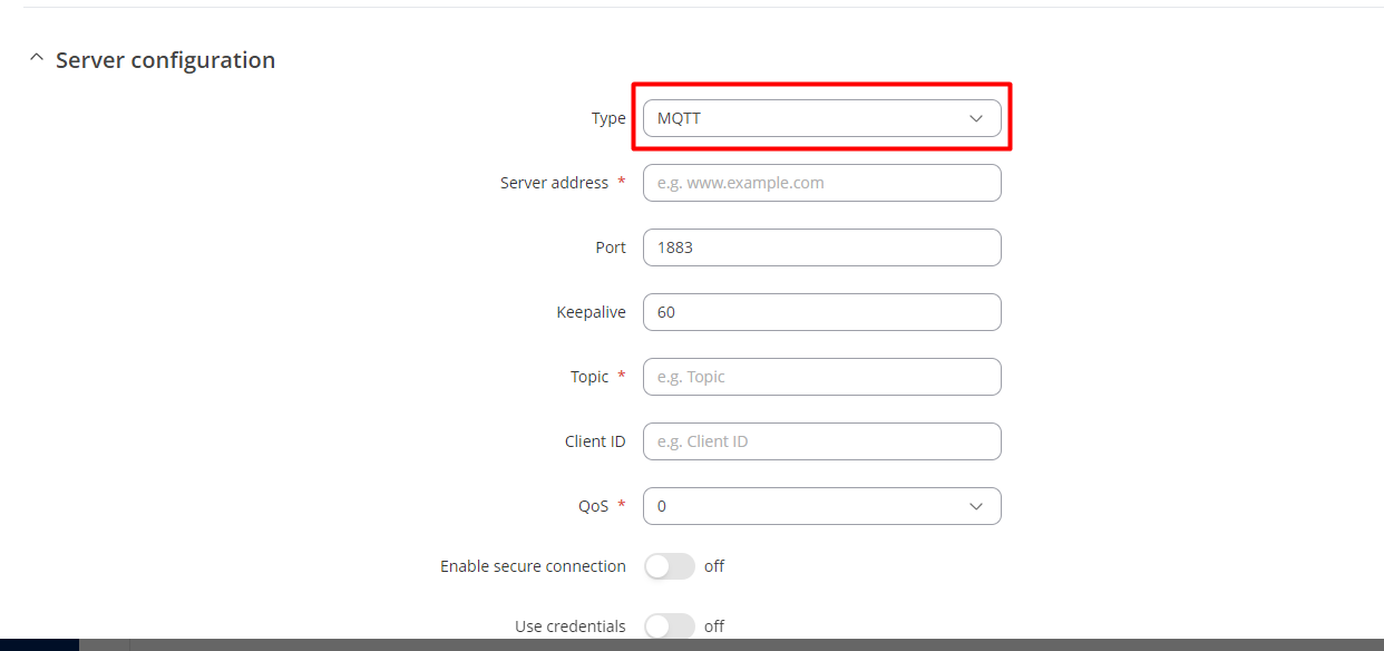

If you have your own MQTT broker, you could change the server type settings as ‘MQTT’ then configure it accordingly based on your desired settings.
