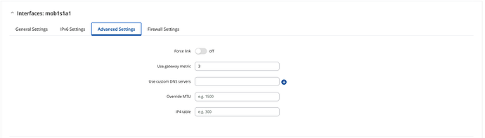

I’d like to enable “framed routing” function in my RUTM5000XXXX but I can’t find the setting. My unit is running firmware version “RUTM_R_00.07.06.10” Here is the screenshot of the network settings in my unit.
Thanks,
Allen

The Framed routing option was introduced starting from the RutOS 7.07.1 firmware version.
To access this functionality, please update your device to the latest or a newer available firmware version. You can find the appropriate firmware files for your model on the wiki Firmware Downloads page here:
