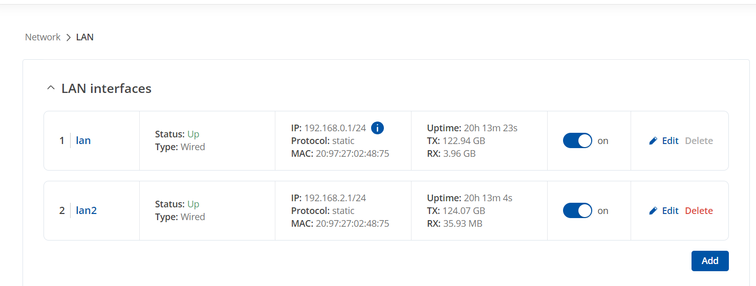

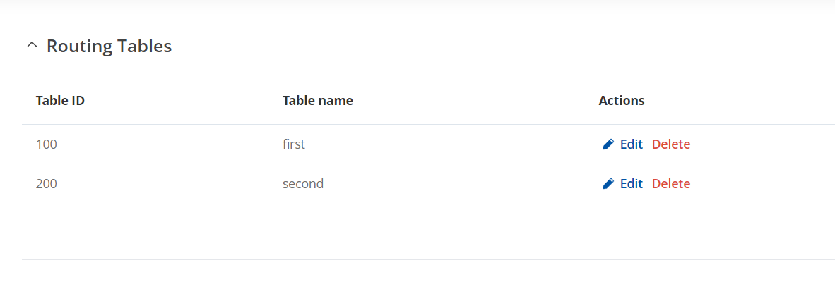

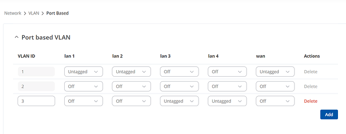

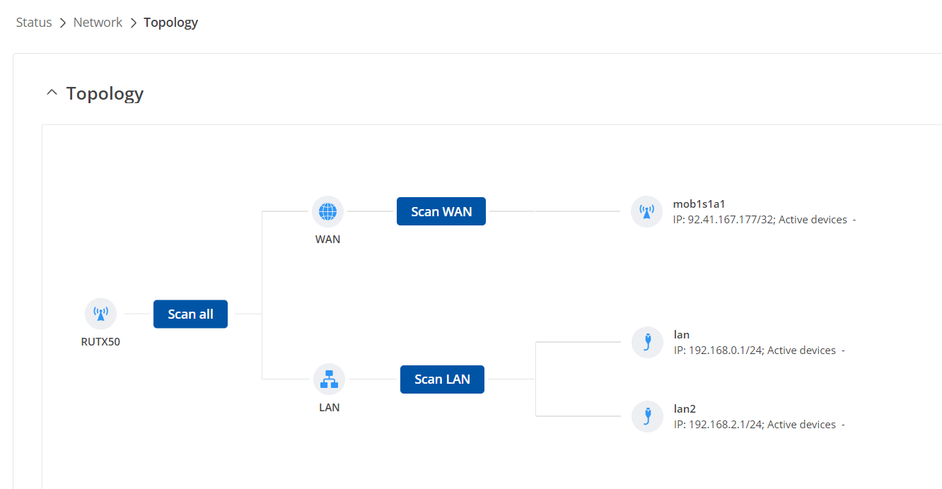

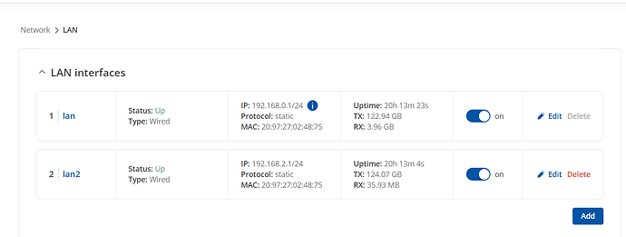

I am trying to get my 2 VLANS to talk to each other? Can anyone see why they wouldn’t with this configuration on my RUTX50? I have tried bridging on and off, it makes no difference.
Personally, I’d get rid of the routing tables and control throuth Firewall Zones … although as the old saying goes … ‘there’s many ways to skin a cat’.
