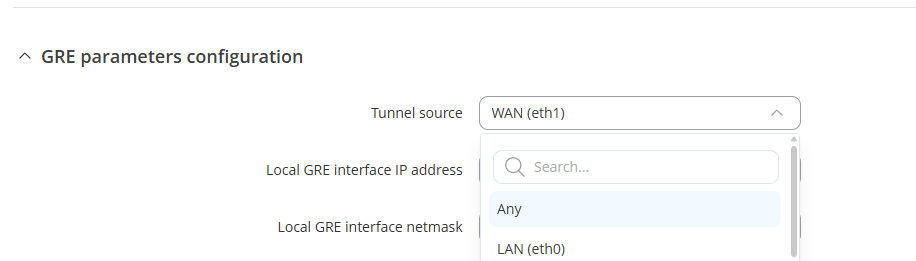

I was able to solve this. The problem is that you need to specify a tunnel source in the GRE parameters configuration. If you leave it to “any” it doesn’t work:
My question now is how to achieve WAN failover - If I specify the tunnel source in the GRE parameters configuration VPN will only work when connected over the selected source - in case of WAN failover VPN will not work anymore…

Thank you for sharing the workaround that helped you resolve the initial issue.
Regarding DMVPN together with WAN failover, this functionality is currently unavailable, but it is planned to be implemented with the upcoming 7.17 release.
