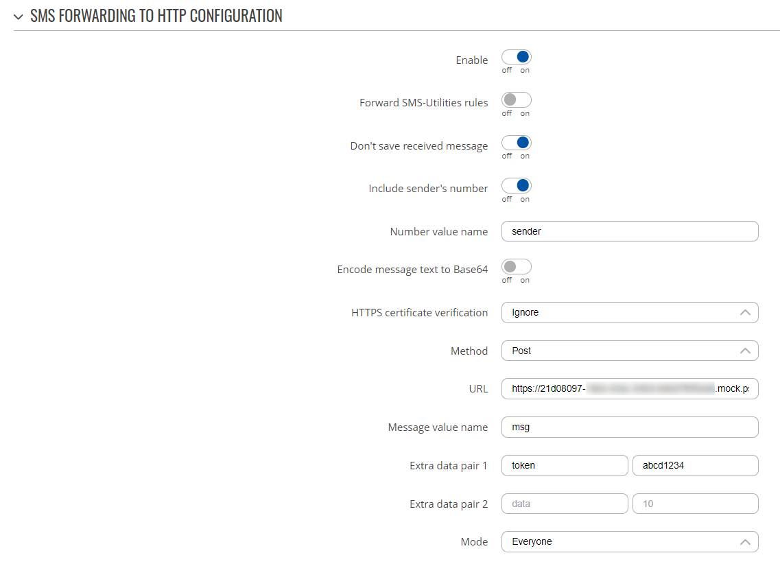

I’ve set up the SMS Forwarding to HTTP instance as follows:

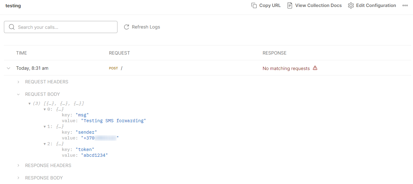

And once the message to the router is sent, I get the following HTTP POST request on the mock server:
As you can see, the Extra data pair was added to the request, along with the sender number and the message contents.
