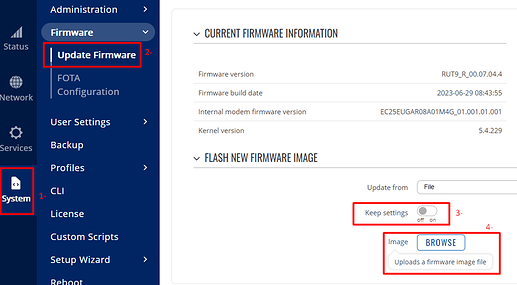

Kindly make sure that the firmware is upgraded to the latest one “7.05.4”, you can find the firmware file on link below
Then once you upgrade to the latest firmware,
