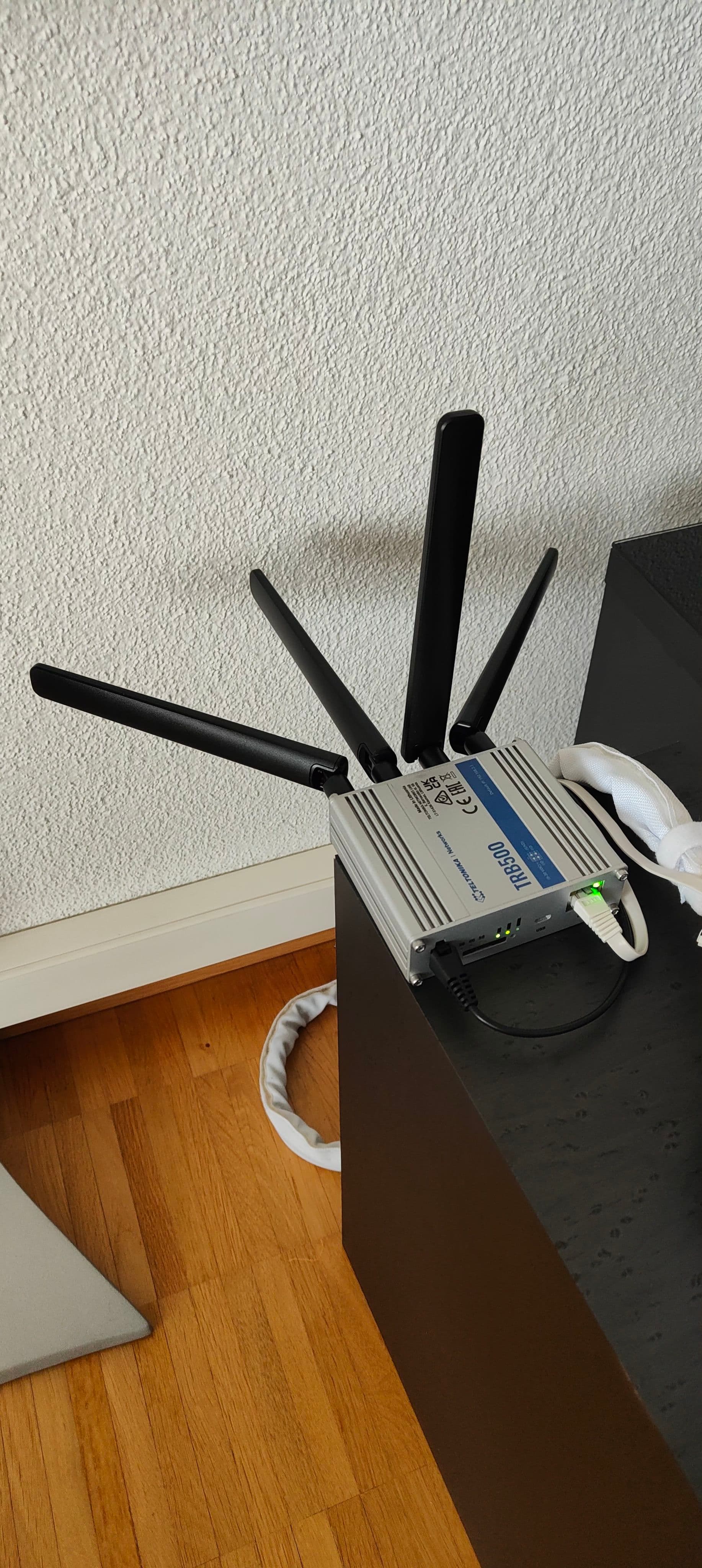

I oriented them so that they point in as many directions as possible.

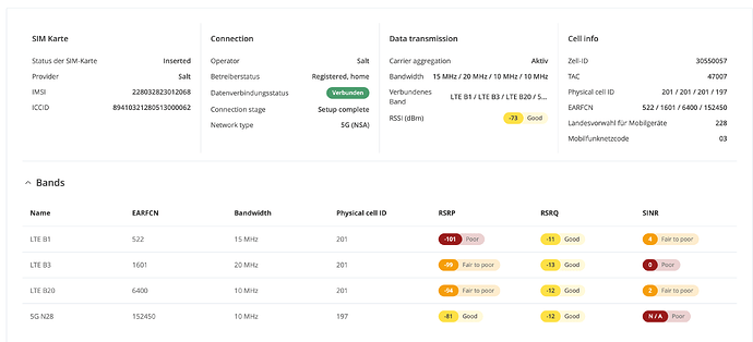

I tried to get feedback by measuring and couldn’t really notice a difference with different settings.
Best regards Thomas

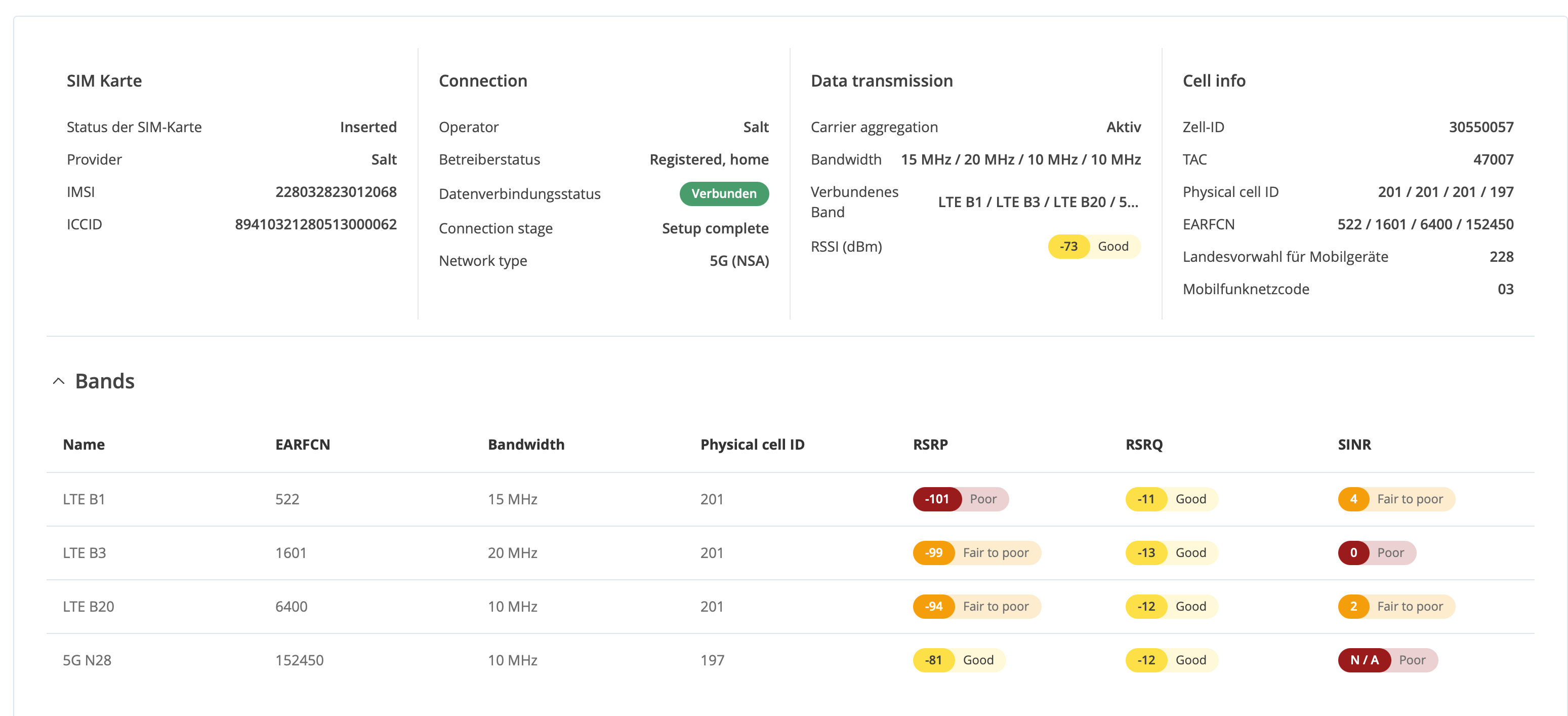

Best regards Thomas

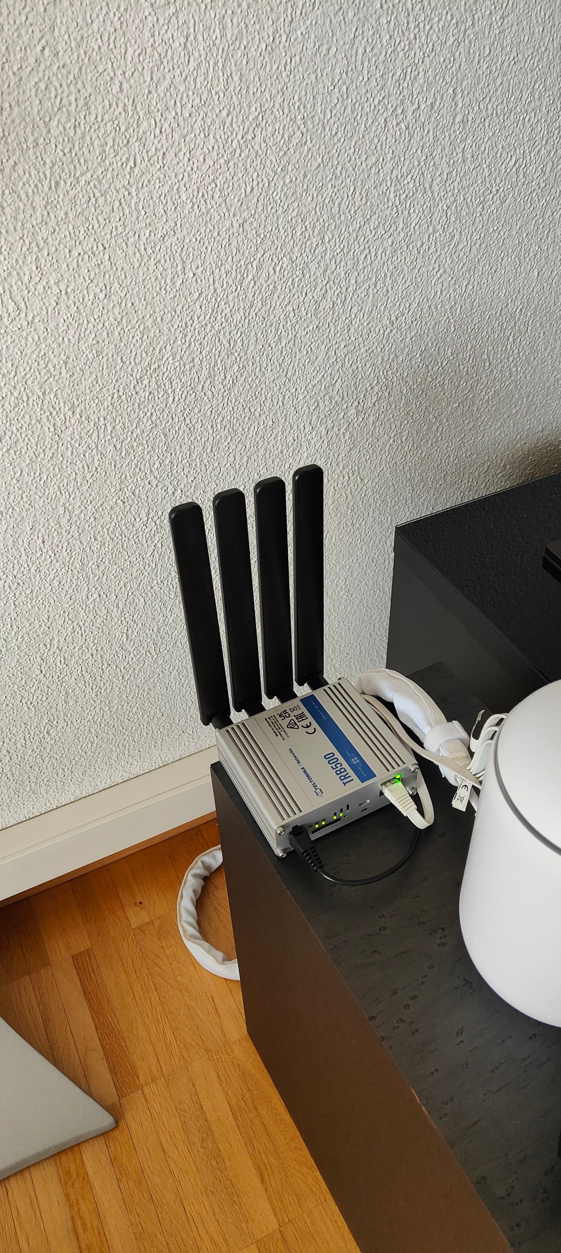

An important factor to consider when placing antennas is their orientation. For optimal coverage with omnidirectional antennas, it’s best to position them directly upright at a 90-degree angle. This ensures that the antennas radiate their signal evenly in all directions, maximizing coverage and reception quality.
While pointing antennas in multiple directions may seem intuitive, it can actually lead to signal distortion or cancellation, especially if the antennas are close together. By aligning them upright, you create a uniform signal pattern that provides the most reliable performance.
