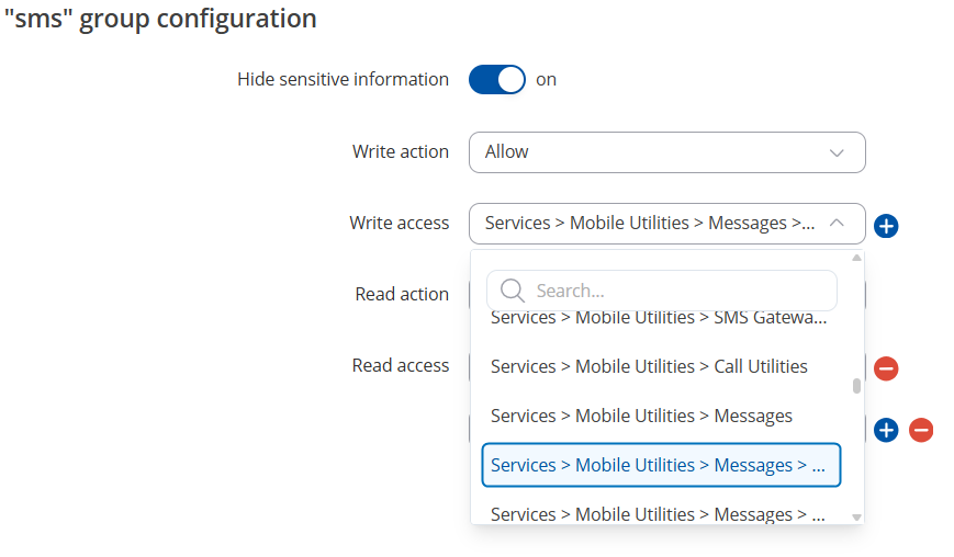

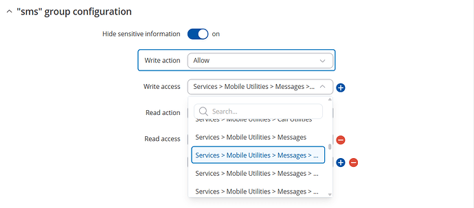

Apologies for the delay. Yes, it’s possible to create a dedicated user assigned to a custom group with permissions limited only to SMS message sending. To achieve this, you’ll need to:

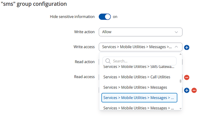

  1. Create a new user group, and in its permission settings, enable only the necessary SMS sending access rights, according to the settings provided in the screenshots below:

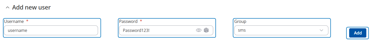

  2. Once the group is created and saved, scroll down to the Add new user section, add a new user, and assign them to the previously created group:
This way, when your API user logs in with those credentials, they’ll have permissions exclusively for the specified SMS sending action.

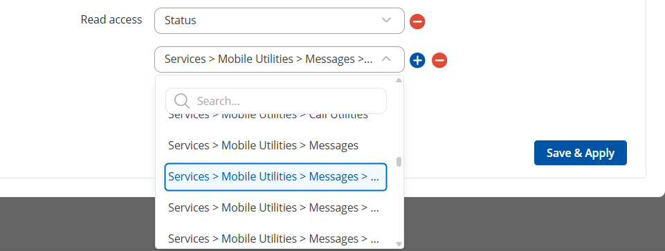

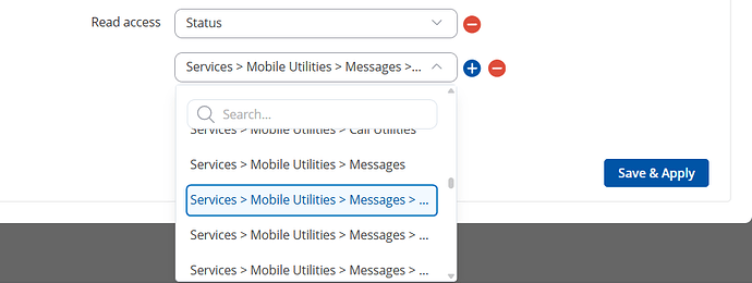

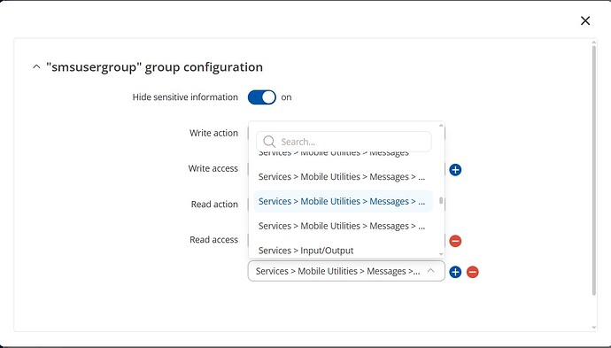

How do I know which write access I selected as I only see the left part and not the important right part in the drop down box?
It is impossible or very time consuming to select it in the proper way, not seeing the full name.
I selected the second “Service> Mobile Utilites > Messages >..” after “Service> Mobile Utilites > Call Utilities” like on your screen shot.

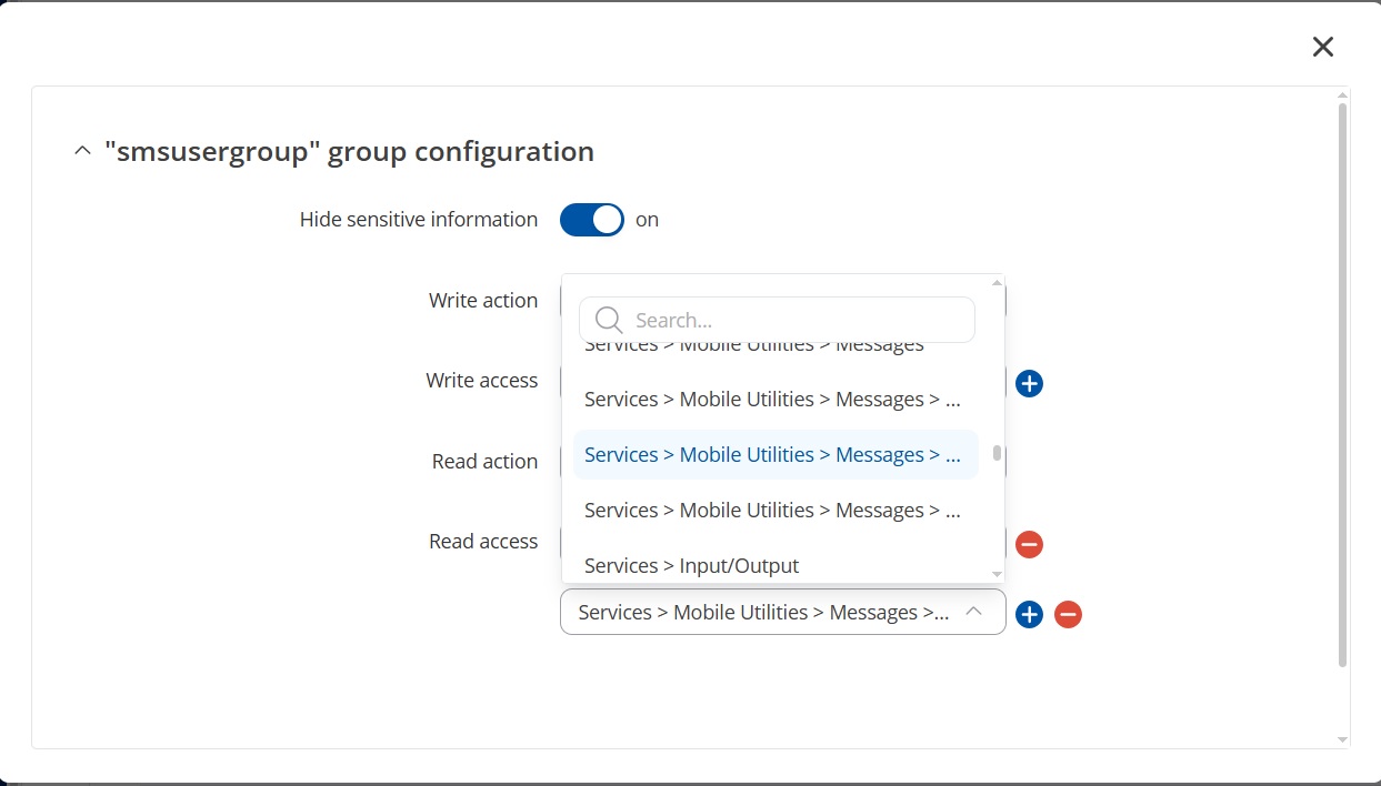

it is the second from below.
Please see the screen shot.
BR,
Peter

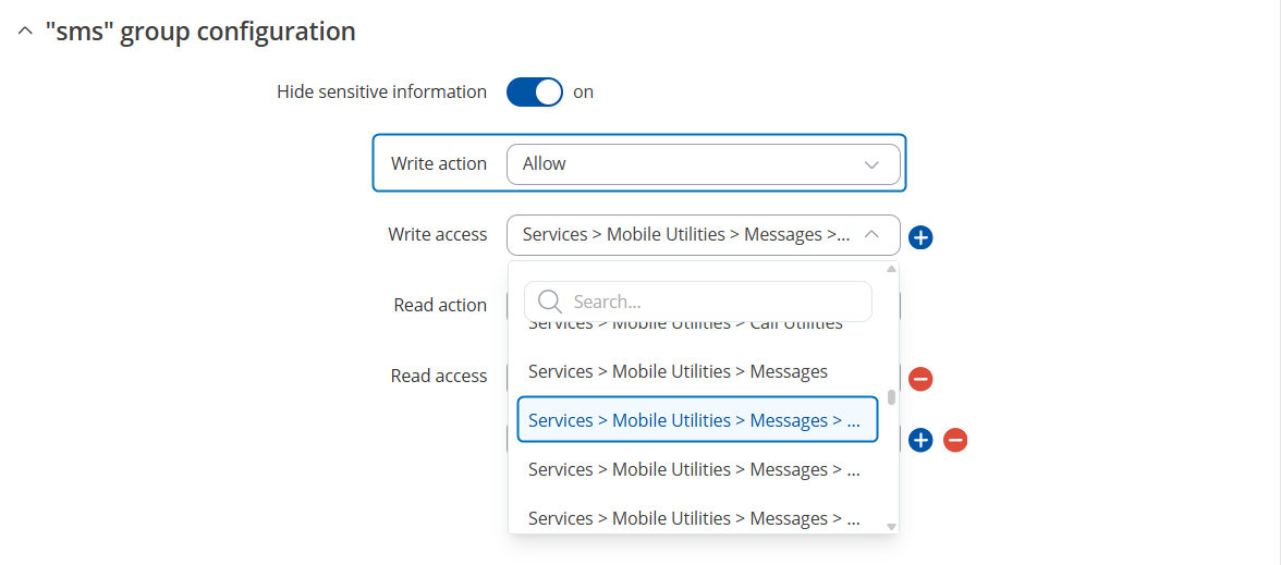

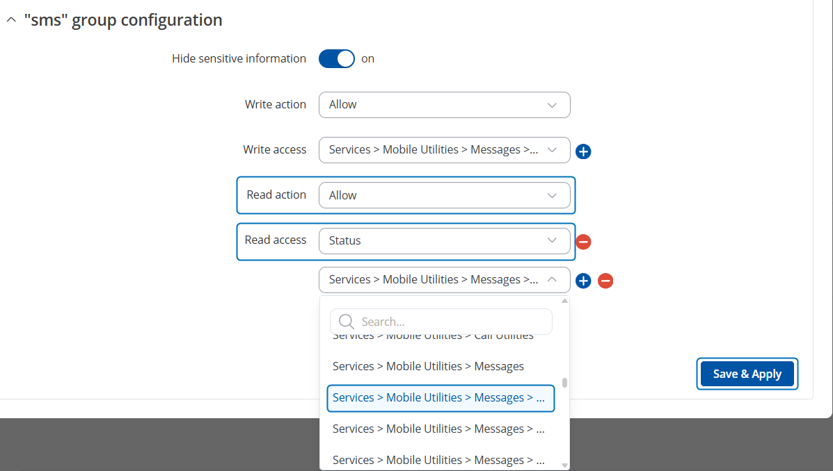

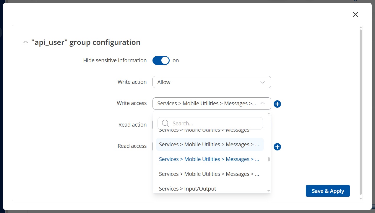

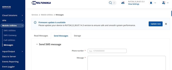

For me, it worked when the first option below the Services > Mobile Utilities > Messages was selected on both Read and Write access.

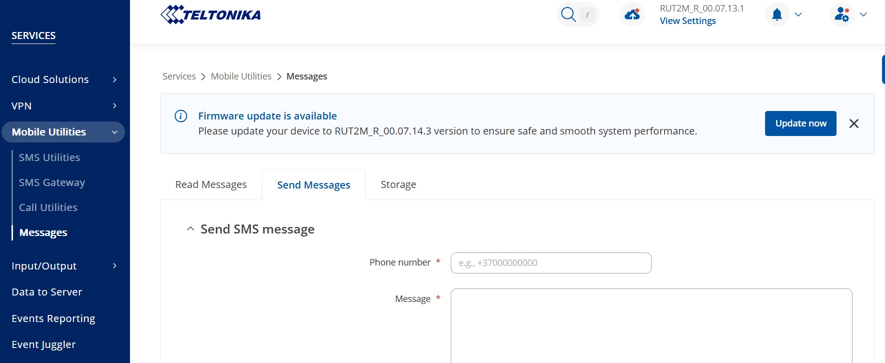

You maybe used a different way of sending the SMS.
I did this test on an older version of the firmware and used:
Services > Mobile Utilities > Messages > Send SMS message
Please see screen shot:
This is the second tab from below.
Anyway it works now. Thanks.
