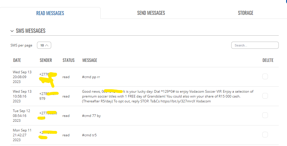

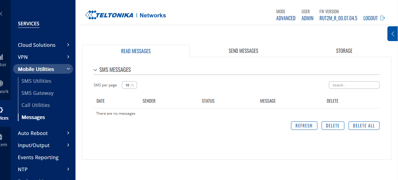

But, the minute I send the SMS with the #cmd abc in it it reeives and acts on only the first sms and then the lights start flashing and one has to wait about two/three minutes where everything is blank on the SMS messages page. A popup occirs which says “Could not retrieve SMS’s” or something like that. Herewith the screen capture of the first SMS cmd sent, followed by a sccreen capture thereafter. As you can see the second image has no message info.
