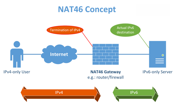

In addition to the points discussed earlier, I’ve now received further clarification from our R&D team.
Based on your described setup and requirements and according to our developer, you’d need a NAT46 setup with the following topology:
However, it’s important to note that even if the TRB140 supported NAT46, it would still require a public IPv4 address. This would, in many cases, negate the benefit of using NAT46, as other options like port forwarding or VPN tunneling would likely offer a more practical and reliable solution, especially since your MikroTik device isn’t strictly IPv6-only and can support both stacks.
